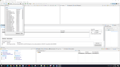

Arathi
Hi Team,
After Creating sample project in code Warrior, I am trying to flash the generated images into board.
When I am trying to add flash device in PA flash Programmer task window under target tasks tab, I am unable to find my flash device (Part number : MT28FW02GBBA1HPC-0AAT).
Hereby attaching the screenshot for the same.
Hi Team,
Arathi

Arathi
Hi @khushbur,
As mentioned in your reply, I have added my Flash device file (MT28FW02GBBA1HPC.xml) into the following Code Warrior installation path
CW_PA_v10.5.1\PA\bin\plugins\support\Products\ProductData\FPDevices.mwpdb\FP\MT28FW02GBBA1HPC.xml
Attaching the flash device file contents below for your reference:
<?xml version="1.0" encoding="UTF-8" standalone="no" ?>
<device-file>
<device>
<version>0.1</version>
<content>
<name>MT28FW02GBBA1HPC</name>
<device_type>nor</device_type>
<manufacturerid>0x89</manufacturerid>
<chiperase>TRUE</chiperase>
<sectors>
<sectorcount>2048</sectorcount>
<sectorsize>0x20000</sectorsize>
</sectors>
<ontargetverify>true</ontargetverify>
<comment>
</comment>
<organization>
<name>64Mx16x2</name>
<id>0x227E</id>
<algorithm>amd16x2.elf</algorithm>
<utility>FlashUtility.elf</utility>
</organization>
</content>
</device>
</device-file>
I am unable to detect my Flash device even after adding the above file.
After connecting to target , when I select Add Device under Target Tasks menu I am getting the below error window
Please do help me resolve this error and Add my Flash device to proceed further.
Thanks and Regards,
Arathi

khushbur
Hi @Arathi
Please modify the product manifest:
     ..support\Products\ProductData\FPDevices.mwpdb\product-manifest.xml
And add the following section at the end:
             <file>
             <path>FP/MT28FW02GBBA1HPC.xml</path>
           </file>
Khushbu
8,568 Views
Arathi
Hi @khushbur ,
Thanks for your reply.
After adding my device file in productmanifest.xml, I was successfully able to get my flash device listed under PA flash Programmer Task in target Tasks menu.
Thanks and Regards,
Arathi

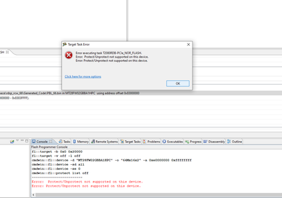

Arathi
Hi Support Team,
I am able to get my Flash device
But I am unable to know flash erase/program my device. Its is showing Sector protect error while erasing.
Can you please help me to select the algorithm for the flash device.
Thanks and Regards,
Arathi
8,341 Views
khushbur
Hi @Arathi
Please execute unprotection operation before doing flash programming.
Khushbu
8,320 Views
Arathi
Hi @khushbur ,
I tried executing unprotection operation before doing flash programming.
Attaching the error response received for unprotection operation
Thanks and Regards,
Arathi
8,233 Views
khushbur
Hi @Arathi
Please modify Init_IFC section in your target init file according to your board and flash device.
If issue still persist than please share console logs and schematic for further debugging
Khushbu
