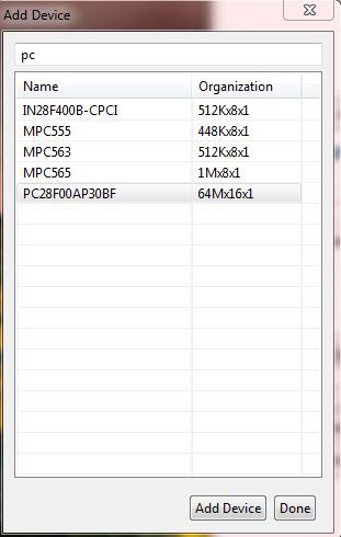

As an example, I am going to show how to add a Micron / Numonyx PC28F00AP30BF flash device. According to the datasheet:
  •     Manufacturer ID = 0x89
  •      Sector Map shows 4 sectors of 16K words followed by 1023 sectors of 64K-words
  •      ChipErase = yes
  •      Algorithm looks like an intel based algorithm, which we can tell from table 7 of the Flash datasheet (I compare the method needed to program or erase a sector to one of the flash parts with an existing XML file)
I create a new file named:
      ..\CW PA v10.x\PA\bin\plugins\support\Products\ProductData\FPDevices.mwpdb\FP\PC28F00AP30BF.xml
<?xml version="1.0" encoding="UTF-8" standalone="no" ?>
<device-file>
<device>
  <version>0.1</version>
<content>
   <name>PC28F00AP30BF</name>
   <manufacturerid>0x89</manufacturerid>
   <chiperase>TRUE</chiperase>
<sectors>
   <sectorcount>4</sectorcount>
   <sectorsize>0x8000</sectorsize>
   <sectorcount>1023</sectorcount>
   <sectorsize>0x20000</sectorsize>
</sectors>
<comment>
</comment>
<organization>
        <name>64Mx16x1</name>
        <id>0x8963</id>
        <algorithm>intel16x1j3.elf</algorithm>
        <utility>FlashUtility.elf</utility>
</organization>
</content>
</device>
</device-file>
I then need to tell CW about the new file, so I modify the product manifest:
     ..\CW PA v10.x\PA\bin\plugins\support\Products\ProductData\FPDevices.mwpdb\product-manifest.xml
And add the following section at the end:
             <file>
             <path>FP/PC28F00AP30BF.xml</path>
           </file>
After saving the files, I open Codewarrior and within the flash programmer, I can now see that my new flash has been added.
