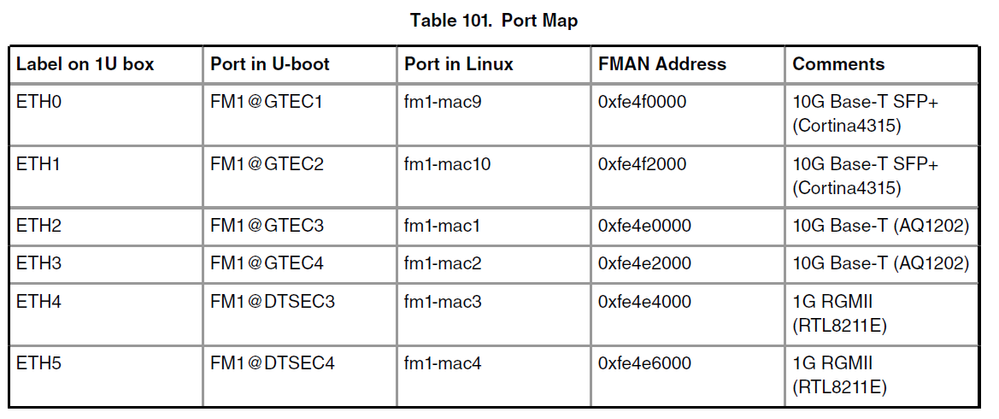

I am aware that there is a typo in the QorIQ T2080 Reference Design Board Quick Start, Table 2 for eth2 and eth3.  As I understand it, the correct info is:
Table 2. Ethernet port mapping
Label on front panel
Port in U-Boot
Port in Linux
FMAN address
Comments
ETH0
FM1@GTEC1
fm1-mac9
0xfe4f0000
10GBase-T SFP+ (Cortina 4315)
ETH1
FM1@GTEC2
fm1-mac10
0xfe4f2000
ETH3
FM1@GTEC3
fm1-mac1
0xfe4e0000
10GBase-T (AQ1202)
ETH2
FM1@GTEC4
fm1-mac2
0xfe4e2000
10GBase-T (AQ1202)
ETH4
FM1@DTSEC3
fm1-mac3
0xfe4e4000
1G RGMII (RTL8211E)
ETH5
FM1@DTSEC4
fm1-mac4
0xfe4e6000
1G RGMII (RTL8211E)
Also, is it correct that the U-Boot port names should be "FM1@TGECn" instead of  "FM1@GTECn" ?
What about "FM1@DTSECn" ?  I am correct in assuming that those are right?
In U-Boot, I have been trying to use ETH2, which should be FM1@TGEC4.  (I have tried others as well with similar results.)  With a cable plugged in, the ETH2 Tx/Rx lights continuously flash alternately.  I am trying to ping the network router at 192.168.25.1.  This ping works fine from other devices on the same network.  I have tested the Ethernet cable, which tests fine, and tried other cables as well.

Please refer to the following port map, ETH2 should be FM1@GTEC3.
In u-boot, please configure ethact as the following.
=>setenv ethact FM1@GTEC3

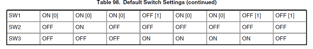

In addition, please check switch configuration as the following.
4,622件の閲覧回数

The switch configuration that you suggest is the standard configuration the board is shipped with.  I have not changed it and my board matches the table you included.
The port map that you presented is the same as Table 2 from the QorIQ T2080 Reference Design Board Quick Start, which I have been referencing.  There are several posts in NXP forums that state there is a typo in this table - actually 2 typos.
  •  First, FM1@GTECx should actually be FM1@TGECx
  •  Second, they state that ETH2 and ETH3 should be reversed, like this:
 I'm not really sure what is correct.  I did a few experiments and here is what I discovered about the form of the names:
It appears that the correct port names are FM1@TGECx.  If I set "ethact" to any port of the form FM1@GTECx, I always get the same response when attempting to ping from the U-Boot prompt:

Based on these tests, it looks like the table does indeed have a typo and
ETH2 corresponds to FM1@TGEC4
ETH3 corresponds to FM1@TGEC3

I have been trying to ping using ETH 2 and ETH 3.  Here is some text from Section 4.2 0 of the T2080RDB Quick Start Guide:
Ethernet
  • ETH 0 - ETH 1: XFI 10G SFP+, connected to Cortina CS4315 PHY
  • ETH 2 - ETH 3: XFI 10GBase-T copper twisted pair cable, connected to AQ1202 PHY
  • ETH 4 - ETH 5: 10 Mbit/s, 100 Mbit/s, or 1 Gbit/s RGMII, connected to RTL8211E PHY
I do eventually want to use ETH 0 and/or ETH 1, but right now I cannot because of the lack of an adapter from the SFP+ connector (used by ETH 0 and ETH 1) to regular RJ45.
This entry states that only ETH 0 and ETH 1 are connected to CS4315 PHY, while ETH 2 and ETH 3 are connected to AQ1202 PHY.  In the Quick Start Guide, I don't see much info about the AQ1202 PHY.
I'm not sure what a good next step should be.  What do you think?

According to your description, ETH 4 - ETH 5 can work normally, u-boot doesn't reply to ping.
ETH2 and ETH3 are 10G Copper ports, please check whether you have used the cable correctly.
Yiping
