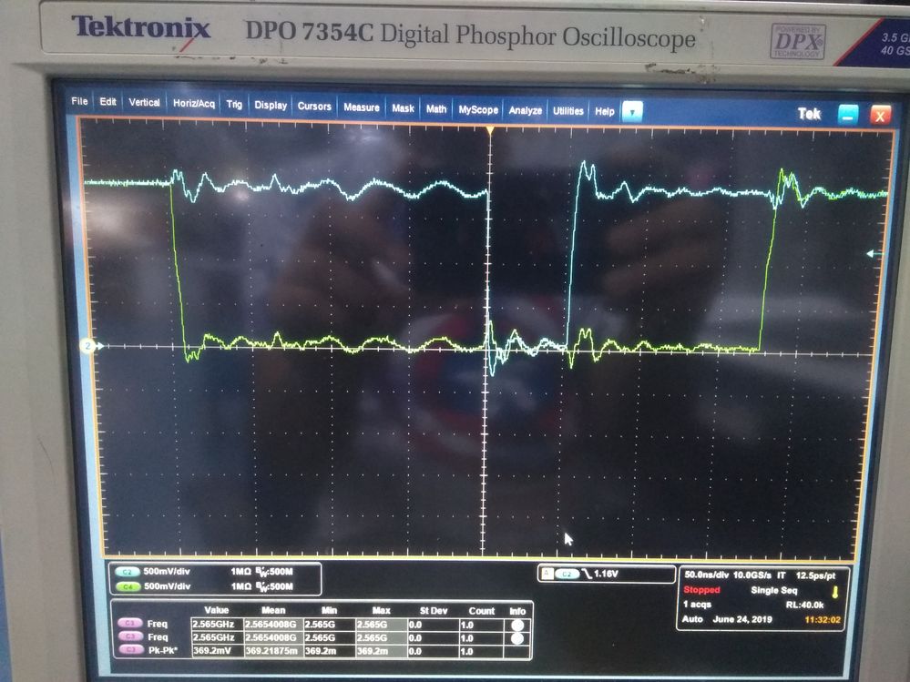

We are having a customized board with T1022 processor. We have connected FPGA on IFC bus with Chip select 1 of processor , and had done respective settings of GASIC mode in include/configs/T104xRDB.h file along with configuration for board/freescale/t104xrdb/law.c file. Both the files are attached .
When we are accessing the CPLD from u-boot , the u-boot generates an error suggesting to reset the board.
We have also tried to access CPLD in linux, there also the read command throws kernel panic exception.
 When we are using logic analyzer inside our FPGA then our state machine is working fine returning the correct data and ready signal at desired time as shown in the GASIC timing diagram in Reference Manual.
When using GASIC write cycle, processor is not driving low on RW signal as observed from Logic Analyzer built inside FPGA.
I am attaching the both log of kernel and uboot crash along with T104xRDB.h (config file) and law.c (Local Access Window file).

ufedor‌ the problem is now resolved.  We are able to access FPGA via GASIC mode.
The problem was we had disabled parity error in  IFC_CSOR1_GPCM, which disables parity checking on received data but parity checking on address is always enabled. Now we have handled that case in our cpld hence the GASIC mode is working now.
I understand there is an option to disable parity checking using bit 2 (PAR_EN) of IFC_CSORn_GPCM register only for data and not for address.
If there is a parity error on address entire , shouldn't the core throw an error instead of crashing. The basic point of parity is to isolate the error so that a wrong cycle is not completed. Is there any setting we are missing to circumvent this ???

ufedor
Uncorrectable error during read transaction is reported to the core as error report machine check.
Please check how this error interrupt is processed in your system.
Refer to the e5500 Core Reference Manual, 4.9.3.1 General Machine Check, Error Report, and NMI Mechanism.

As per the hardware team this is the trace of failing read transaction.
What is the difference between traces of the transactions "md.w 0xffdf0000 1" and "md.w 0xffdf0050 1"?
-> No difference.  they are two different addresses of FPGA .
One additional information the read happens successfully for first time, every time we power on the board but u-boot gives crash log on subsequent reads.

ufedor
In the provided T104xRDB.h:
> #define CONFIG_SYS_CSOR1        CSOR_GPCM_GPMODE_ASIC
Ensure that the FPGA asserts RDY_L within 256 cycles of IFC module input clocks.
4,116 Views

ufedor
Please provide a digital scope or logic analyzer trace corresponding for the failing read transaction.
4,116 Views
hemwant
The waveform for CS and RDY_L is attached. The green waveform is for CS and the blue
waveform is for RDY_L. There are four IFC clock cycles between them (IFC running at 18MHz,
55ns clock cycle). The processor is also de-asserting CS indicating it has completed the
4,116 Views
ufedor
Please confirm that this is the trace for the failing read transaction.
