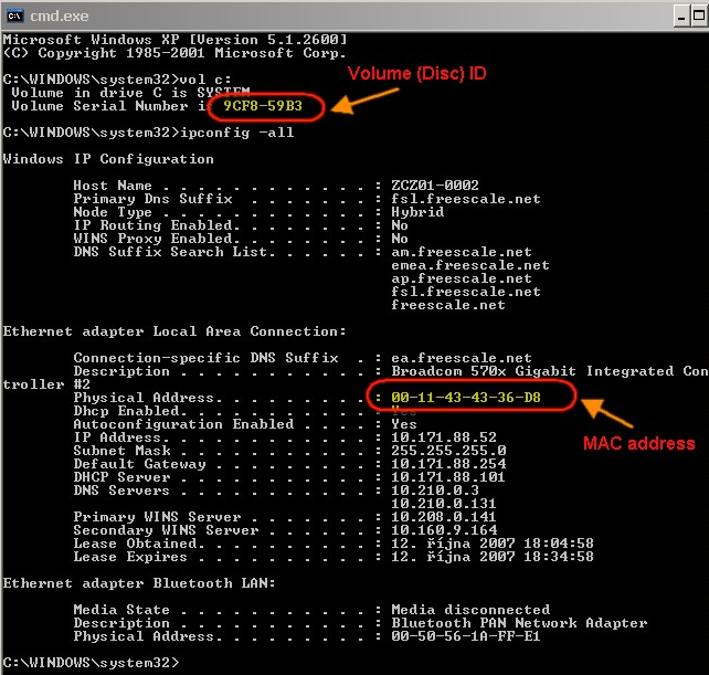

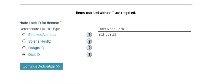

Only half of the host id that I entered is displaying in the license file. I get an error "LM_NotThisHost". Also - What should be entered in the "name" field when generating the license file?
784 Views
stanish
Hello Ray,
I assume you entered Disc Serial Volume Number which has minus as a separator XXXX-XXXX
Or MAC address (see below).
In any case do not use "-" character as a separator when entering the locking ID:
