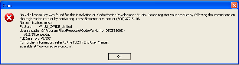

I use Codewarrior 8.2.3 for developing existing product however I cannot get the licence.dat file to work on another machine.
I follow the instructions on the pdf given at
How to rehost CodeWarrior suite license
However after I generate and save the file I get the following error when attempting to run Codewarrior.

I check the system and see you have license locked to
Ethernet Address: XXX3FF189D10
Is this the correct Ethernet Address?
The error shows the system is no able to see the license.dat file, OS
This product is a 32-bit application. To install and use it on Windows 7® 64-bit machines, see the white paper, “Installing CodeWarrior Classic on Windows 7 (64-bit) “ in the Featured Documentation section.
http://cache.nxp.com/files/soft_dev_tools/doc/app_note/AN3936.pdf?fsrch=1&sr=4&pageNum=1
