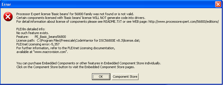

Had a failure on a PC I was using, and had to transfer to another machine. I re-installed Codewarrior 8.3 on a Win XP machine and used the NXP website to generate a new licence. The problem is that the Processor Expert does not appear to be licenced and will not generate code, and I also get the following error message when trying to build my system :-
"Could not find or load the file MSL C 56800E lmm.lib"

In order to share your license information I invite you to create a case in out private community
1) Go to http://www.nxp.com/support/sales-and-support:SUPPORTHOME.
   2) On the bottom of the page under Submit New Issues, click Hardware & Software.
   3) Register with your business email to access NXP technical online support.
   4) A verification email will be sent to your account. Click the link embedded in that email to verify your access.
   5) On the NXP online support page, select Contact Support from the top menu and click “submit a new case” to start the process.
Some processor expert components can have issues on Os with 64 bit platform.
Create a case to check your details .
