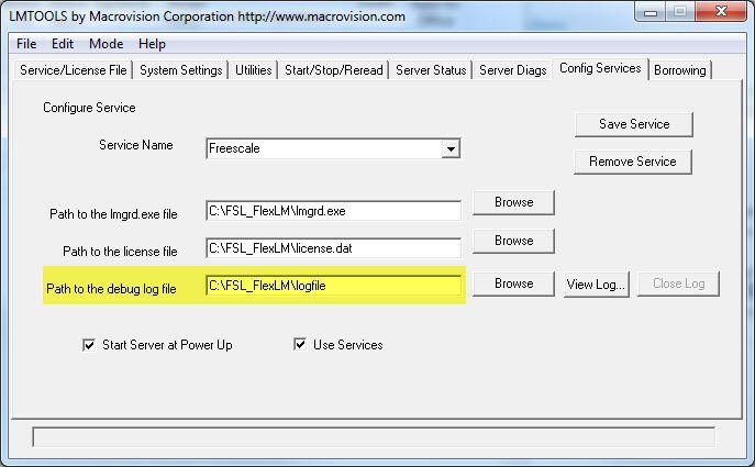

We should look the log file located in path specified on LMTools
being on/off issue, the check out check in could be the problem. Please create a support case to check your particular case
