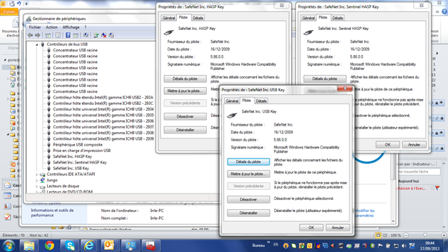

Good morning everybody,
I’ve used CodeWarrior 7.1 with a USB Dongle Licensing since 2009 without any problems, in a laptop with OS Windows XP (32bit).
My problems arose when I installed Windows 7 (64bit).
With Windows 7, I installed CodeWarrior 7.1 Development Suite (by means of CD),
USB Dongle Drivers (I downloaded the updated version from www.freescale.com) and the FLEXIm software (it downloaded as well from the site in updated version).

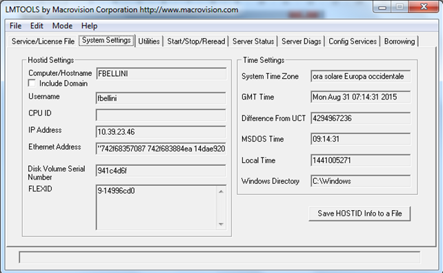

I tried to read the USB Dongle FLEXid with FLEXIm software and I got the following positive result:

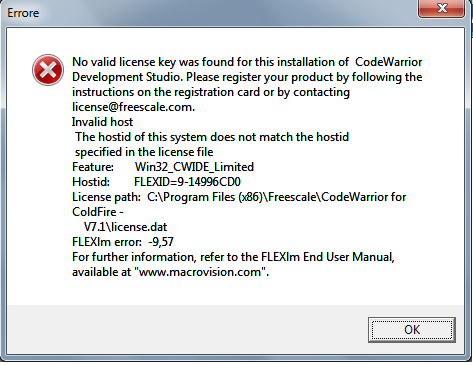

At this point, I placed my “old” file license.dat in my CodeWarrior installation root directory and I tried to open a CodeWarrior project. Here I’ve found the problem and the following error window popped up.
I think there is a problem related to the new software version of FLEXIm, it recognize the USB, is able to read the ID but it can’t link it with the CodeWarrior or something like that.

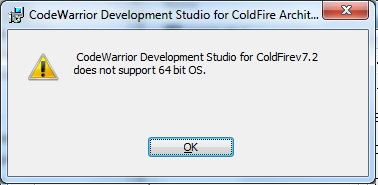

I tried also installing CodeWarrior7.2 (downloaded from the www.freescale.com) but the following screen appeared:
I've not been able to find a version for 64bit.
Are there anybody who can help me?
Thanks in advance.

2 years ago I've performed a test with CW for Coldfire V7.1 + Win 7 64 bit with an USBDongle license file
Unfortunately the USBDongle is not working for this version.
However this is working for CW for Coldfire V7.2.
Below you will find more information.
A- Test for CW for ColdFire V7.1 + Win 7 64bit + USBDongle

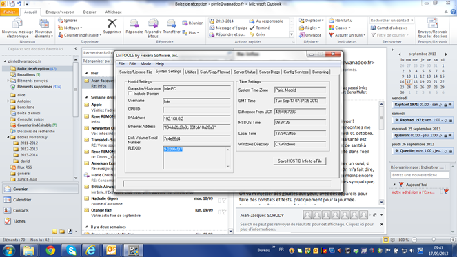

  Dongle FlexID

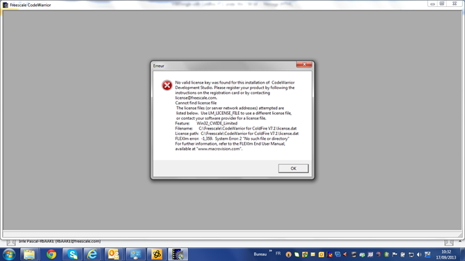

Without license file I got the error (normal):
Now put the default license file downloaded from web system.
I got an error:
The system complaint because a feature is missing: Win32_CWIDE_Limited.
This feature is not included by default because the license file has another feature:
Win32_CWIDE_Unlimited metrowks
For older version, sometimes the Limited feature is required.
I’ve edited the dongle license and add at the beginning the feature:
INCREMENT Win32_CWIDE_Limited metrowks 5.500 permanent uncounted \
B3CDA540C23B VENDOR_STRING="CodeWarrior IDE 4.2 or later, \
Windows, limited" HOSTID=ANY TS_OK
Now I can launch the IDE without problem.

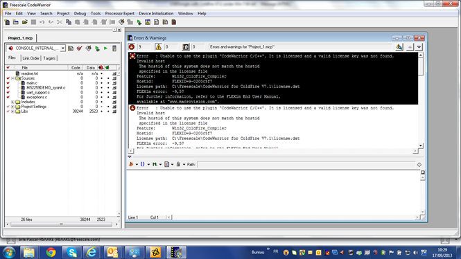

I’ve created a new project and build it.
I got errors:
The USBdongle is not recognized by the tool.

B- Test for CW for ColdFire V7.2 + Win 7 64bit + USBDongle
Questions:
A- Can I use CW MCF V7.2 under Win 7 ?
You can not install CW for MCF V7.2 on 64 bit system.
The installer is checking the OS you're using and will not allow to run the installer under 64 bit.
The solution is to:
- install the tool on XP or Win 7 32 bit machine,
- copy the installation folder under your Win 7 64 bit machine,
- execute the \bin\regserver.bat file.
Now the tool is installed on your 64bit machine.
Another problem is linked to the P&E driver.
The installed driver is not compatible with Win 7 64 bit machine.
You must download and install new version.

B- Can I use USBDongle with CW for ColdFire V7.2 under Win 7 ?
Yes - My configuration: Windows 7 64 bit + CW for MCF V7.2 + USBDongle
When I launch the IDE I get a message saying "This is the last days of current license".
This is a common problem met with other classic tool as DSC V8.3 and HC12 V5.1.
Every time, every day you will launch the IDE you will get this message … but the license will work.
So don’t care about it.

I've created a short example.
When the USBDongle in unplugged I got a license error:
Error  : Unable to use the plugin "CodeWarrior C/C++". It is licensed and a valid license key was not found.
Invalid host.
The hostid of this system does not match the hostid
specified in the license file.
Feature:      Win32_ColdFire_Compiler
Hostid:        FLEXID=9-4d125250
License path: E:\Freescale\CW_SC_3850_v10.7.1\eclipse\../SC/license.dat;E:\Freescale\CW eTPU v10.2.2\eclipse\../ETPU/license.dat;C:\license_all\license.dat;E:\Freescale\CodeWarrior for ColdFire V7.2\license.dat;
FLEXnet Licensing error:-9,57.  System Error: 2 ""
For further information, refer to the FLEXnet Licensing documentation,
available at "www.macrovision.com".
When the USBdongle is plugged I can build the application.

Coldfire V7.1 is working fine with license file locked on DiskID or HostID.
Unfortunately this is not running with USBDongle license file.
