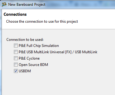

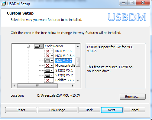

Hi Peter,
I assume you refer to CodeWarrior for MCUs v5.1 (classic IDE).
For building the project you can use latest CodeWarrior for MCUs 10.7. - Free Special Edition.
This version offers 64KB of object code which is more than enough for almost all S08.
I've downloaded/installed USBDM v4.12.1 and it seems it supports CW 10.7 as well:
I don't have any USBDM hw so I cannot test if it really works.
Hope it helps.

Thanks Stanislav.
I eventually realized that was the case and installed V10.7.
I have built demo code for the demo08QG board and all is fine.
It is likely I will buy a USBDM or two for production purposes so nice to know it is supported.
