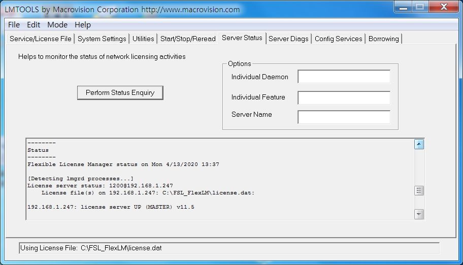

I had used an evaluation version of CodeWarrior® Development Studio for HCS12(X), I purchased a license of CWP-STANDARD-FL-ND a few days ago.
I conducted registration and generated a license key of Development Studio for HCS12(X).
And then I set up the license server environment.
(referring to "FLTLICINSTWINBR.pdf", at the client-side, I pasted "license.dat" from the server and set system variable)
Host and client PC are combined through a local network.
However, I got this message, when I try to compile.

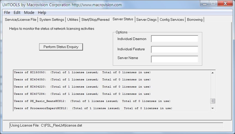

At that time, the license server's status is like below.

For debug this issue, please try to add [email protected] into LM_LICENSE_FILE environment variable.
CodeWarrior will first have a look there for the valid license before it checks the license.dat in the local folder.

HI Hansung,
it seems that the client machine is not connecting to the server, can you share a screen capture of the variable you created and also the location where the license file has been hosted on the client side.
