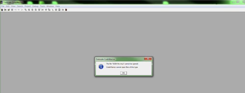

zhaoqinsu
 Thanks for your help ,Codewarrior works well now . But it can't open suffix ".mcp " project .Have you ever met this situation?
5,142件の閲覧回数
stanish
Could you make sure the project you are trying to open is indeed intended for the version of CW for MPC5xx ?
S32K14x sounds to me like an arm based rather then MPC5xx.
S.
5,142件の閲覧回数
zhaoqinsu
Yes , it is indeed intended for the version of CW for MPC5xx.
The  project has run on other guys' Codewarrior.
Important to note, we are using the exact same versions of codewarrior and I am able to open and work with other codewarrior projects
