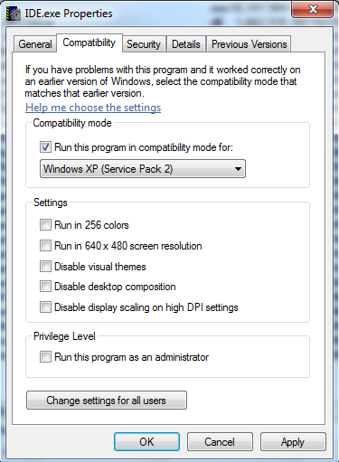

Could you possibly try to experiment with windows compatibility mode?
Anyway I'm afraid if it does not help my only recommendation is to install this old version into a Win XP 32 bit virtual machine (VirtualBox, VM Ware, Virtual PC...)

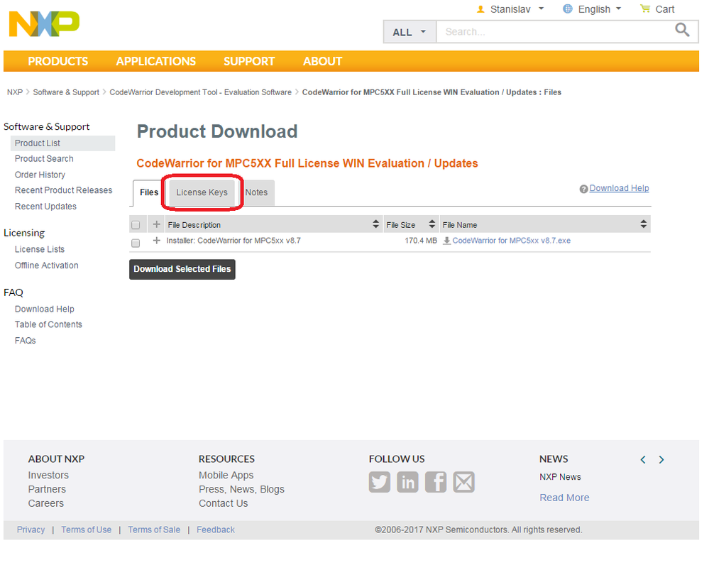

this is pretty old version of CodeWarrior for MPC5xx v8.7.
This version has never been tested on Windows 7+ therefore you might face problems when trying to install it.
You might experiment with both options to figure out which one leads to complete installation.
If you debug using PEMicro P&E probe you can try to install updated drivers that should supports Windows 7, 8, 10
http://www.pemicro.com/downloads/download_file.cfm?download_id=53
The evaluation license is included in evaluation edition installer:
http://www.nxp.com/webapp/swlicensing/sso/downloadSoftware.sp?catid=CWX-MPC-5XX-EX
You can access it via your nxp.com account:
Hope it helps.
Stan

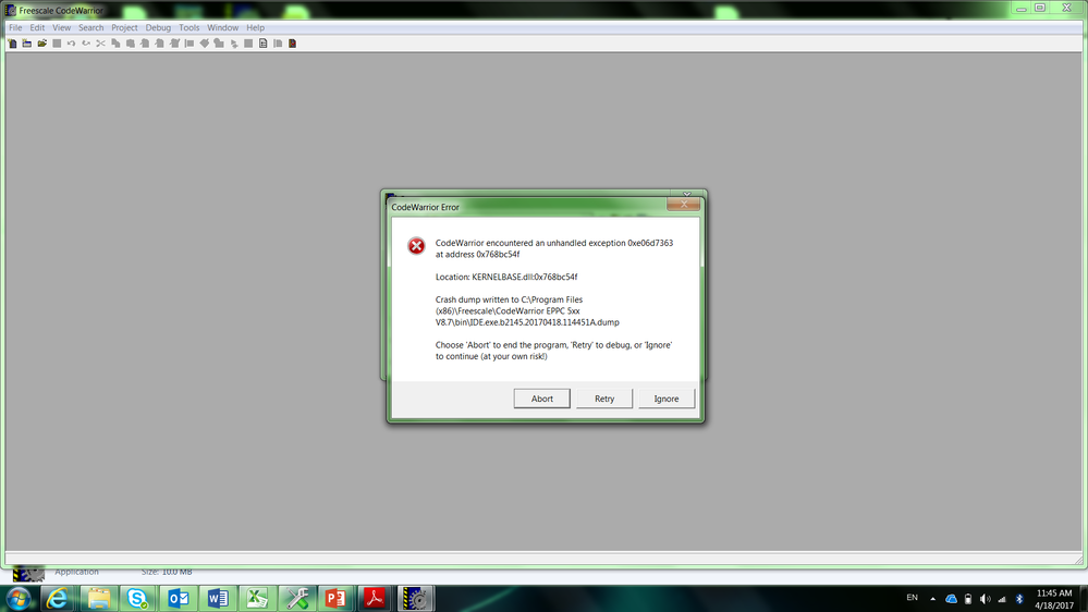

zhaoqinsu
Hello Sliva ,
I can give you  one picture of my installing Codewarrior when it comes error ,Can you give me some advice installing Codewarrior?Untitled.png

stanish

 Thanks for your help ,Codewarrior works well now . But it can't open suffix ".mcp " project .Have you ever met this situation?
