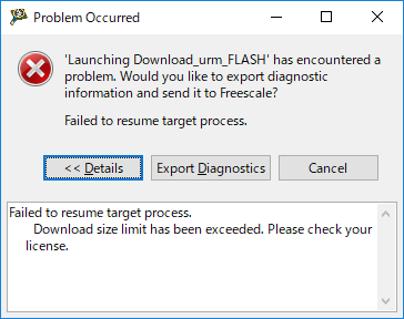

When I tried to debug on CodeWarrior 10.7 on Windows 10, I get a error "Download size limit has been exceeded.".(filed_to_resume_target_process.png)
How do I solve this issue?

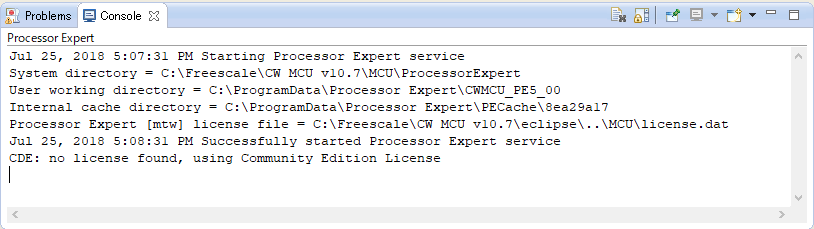

I assumed this is due to license, then I checked license.dat and lmtools have same FLEXID. (as shown lmtools.png and license.dat.png)
license.dat is located at C:\Freescale\CW MCU v10.7\MCU.
And I get a message "CDE: no license found, using Community Edition License" when I open codewarrior.

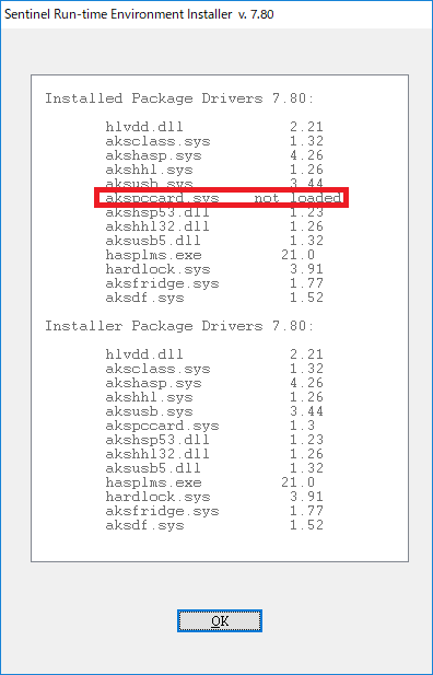

junfujimoto
Thanks for your response.
I tried to reinstall dongle drivers as per your advice.
But the issue is still occurred.
I can see FLEXID on lmtools.
Does this mean I've installed drivers correctly?
And I get this result when I run haspdinst.exe -info.
This shows akspccard.sys is not installed. Is it no problem?
