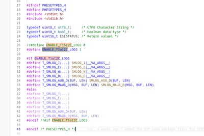

While trying to debug the nano library and verify what is happening (I have an error) I enabled debug printouts
in file https://github.com/NXPPlugNTrust/nano-package/blob/075f8cc9a27a5e5eb6a04f3d86c1a421836777e8/lib/t1oi...
There is a line - T_SMLOG_MAU8_D("RAW Rx<", nxpese_ctxt->p_read_buff, ret);
I get a hardfault on my microcontroller, since "nxpese_ctxt->p_read_buff" is null and the debugger is setup to break on accesses to address 0. I suspect that the intention is to print "pp_data" contents instead?
There seems to be no way to report issues in Gitlab, so I simply try here... I'm rather new to this so I might be mistaken or have misconfiguration something, but it seems a bit strange...

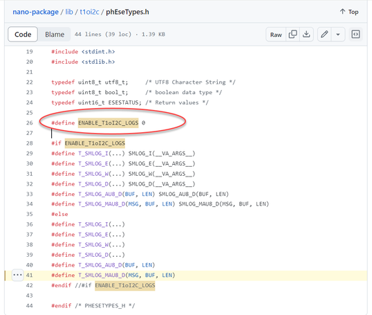

Hi @andershedbeg ,
Did you define this macro to 1?
Kan

Hi @andershedbeg ,
What is the platform you use with the nano package? I guess there might be some porting issue here.
Kan

Hi, yes, like this:
