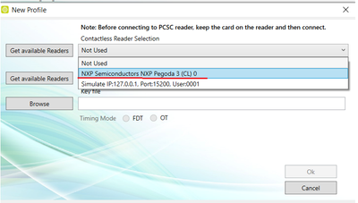

KaiLi
Hello @vitorciola
Yes, V5.4 is a little different from V5.0. In your case, the Pegoda reader was not found, so you will need to follow the instructions in Section 3.3 of UG10039 and then see the device as below, which should work properly.

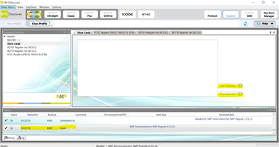

vitorciola
Thanks! The reader could be connected after the instructions on 3.3, however none further commands can be executed on the card:
Is there any additional step missing?
5,020 Views
KaiLi
Hello @vitorciola
Sorry, I made a mistake, and the late reply.
If only Reset is available, the device is still in PS/SC mode, so at this time, you need to perform the operations in section 3.4 of CLRD730 Quick start guide (nxp.com.cn) , switch to VCOM mode, and then you can see the following interface.

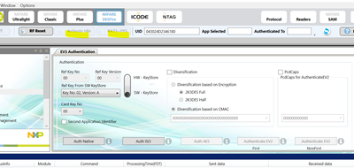

KaiLi
Hello @vitorciola
Yes, Pegoda is like that. This is already available. I have tested Authentication of MIFARE DEFIRE EV3 here and everything is fine. But there is a suggestion for you, first place the card on Pegoda and then start RFID Discover.
