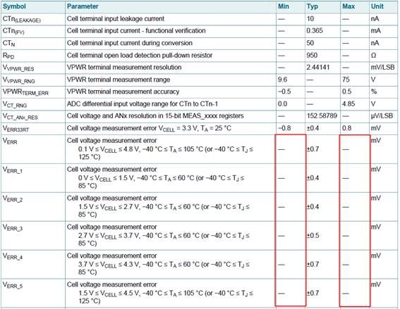

我們目前在SPEC還無法得知的如下圖部分, 對於Cell voltage Max/Min error value?
about mc33771 that Cell voltage Max/Min error value?
i want know -40c~125c full temp range?
please gibe us the Verr ~VERR5 that min/max at  -40c~125c
our customer want to know which range.
do you test report at mc33771?
see attached pdf
MC33771B_SDS
Battery cell controller IC
Rev. 5.0 — 2 May 2018 Short data sheet: technical data
page 13/29
asap tell me

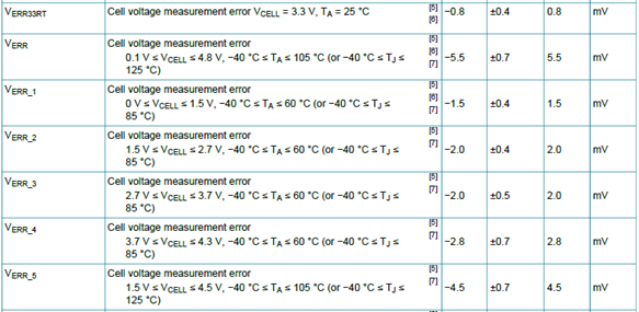

Hello Jaures,
Please see the complete values below:
If you want a complete datasheet, please create a standard ticket to request it.

jaures168
hi Paulina
Which ones are temperature offset, which are constant errors!
if constant errors than us use software calibration.
and do you detail test report ?
we want to detail review the report.
may we can save the error!

lisettelozano
Hi Jaures,
The values showed in the image are constants errors for the temperature and voltage range mentioned on each one of them.
In regards to the test report, unfortunately, we do not have that document or information to provide. I apologize for the inconvenience that this may cause.

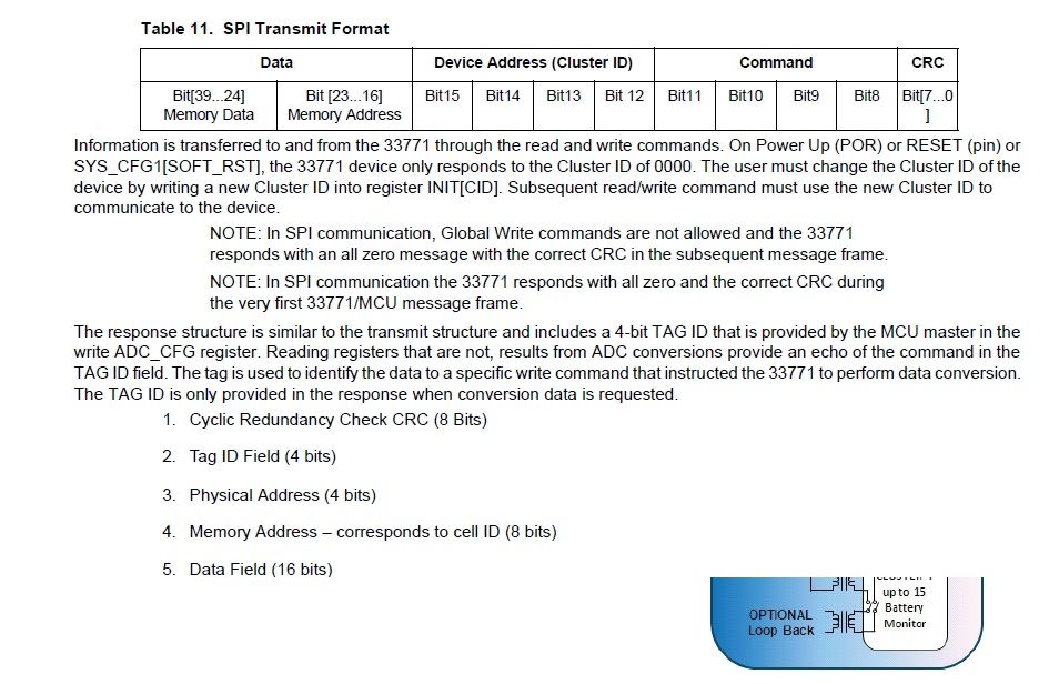

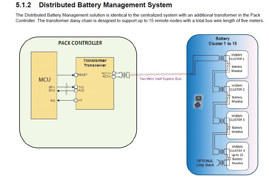

i want to use  mc33771 14 pcs  series to 196 cell,but how to initial
about the transformer daisy chain the cluster 1~15 :
how to use software to set the cluster 1~15?
Use Device Address (Cluster ID) 0~15 to setting daisy chain the cluster 1~15.
but how to initial the Device Address (Cluster ID) 0~15.?
do you app note to me,or tell me how to use software to set  mc33771 14 pcs?
