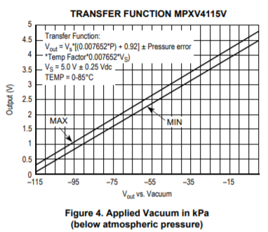

reyes
Hi Patrick,
For the case of the MPXV4115V, around +5V on the output when 0.00 inches of Hg is correct. Check the image below:
If you are measuring pressure level on the range of -30 inches of Hg, then the MPXV4115V or the MPXV6115 are better options than the MPXV5050V, in the case of the MPXV4115V, when reaching -30 inches of Hg (-101kPa), you should get around 0.7V
Jose
