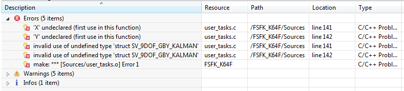

I downloaded the KDS 5.0 as you suggested. I am curious though because the library says FSFK K64F, but this board is the FRDM K64F. This doesn't seem to be a problem though. I am getting an error during building.
I did manage to get rid of X and Y being undeclared by changing the to 1 and 2. But I couldn't find this anywhere else in the code. Do you know if these correspond? Also, here is the code that I dropped into the UserMediumFrequencyTaskRun()
// PUT YOUR CODE HERE
accx = thisSV_9DOF_GBY_KALMAN.fAccGl[X];
accy = thisSV_9DOF_GBY_KALMAN.fAccGl[Y];
4,510 Views
markpedley
The FRDM*** projects are simplified versions that run on the Freedom boards using the sensors available on that Freedom board. The FSFK*** are the full versions that require the MQX-Lite RTOS and require the gyroscope sensor available on shield boards to run the most sophisticated algorithms.
We changed the compile time constants X, Y, X to CHX, CHY, CHZ (with the same values 0, 1, 2) to avoid conflict with Processor Expert which was also using those same names. So just change your previous references in your code to X, Y, Z to CHX, CHY, CHZ.
