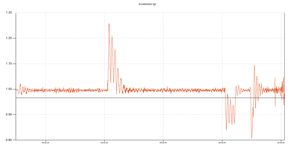

Hi. I am building a game using a MMA8451Q breakout board connected to an Arduino Uno.  The standalone device, powered by battery, must create an interrupt if z-axis acceleration exceeds a value (say, 2g) AND the vertical movement exceeds a value (say, 30mm).  I calculate the vertical movement by double-integrating the positive acceleration readings.
My problem is that tell-tales I have in the software show inconsistent results between vertical lifts.  Even when it appears to work, the vertical acceleration required to get it to wake up and fire is way more than the threshold I have set.  I have been struggling with this problem for weeks now.  The Application Notes for the MMA are confusing for me, and I would really appreciate some feedback on my software, and particularly the register settings, which I attach.
Many thanks in anticipation!

anthonyduhamel
Hi Mark,
First of all, let me check with you your program. If I well understand:
- The arduino init the sensor and then goes into sleep mode (the sensor is also in sleep mode).
- When the transient function is triggered, the MMA8451 switches to normal mode.
- I guess the sensor interrupt is catched by your arduino and this wake it up. This is just strange how you coded it. It should be an external interrupt handler and not called in a loop.
void setup()
// your init
void pin2Interrupt(void)
  detachInterrupt(digitalPinToInterrupt(pin2));   // stop firing while interrupt pin is low
  Serial.println("ISR Arduino Awake!");
  exitSleep();
void exitSleep(void)
  sleep_disable(); // I think this is automaticaly done by your LPWU pin)
  Serial.println("Arduino exiting sleep");
void enterSleep(void)
  Serial.println("Loop Arduino entering sleep");
 attachInterrupt(digitalPinToInterrupt(pin2), pin2Interrupt, LOW);   // Setup pin2 as an interrupt and attach handler
  set_sleep_mode(SLEEP_MODE_PWR_DOWN);
  sleep_enable();
void loop()
 enterSleep();
 // when wake up interrupt goes there
  while ((x <= reps) && (cumS < minLift))      // while loop with 2 conditions
- then the arduino try to compute the displacement from the acceleration
Am I wrong?
About your MMA8451 configuration:
RegisterValueDescription
CRTL_REG10x21Active mode, Normal ODR=50Hz, Sleep ODR=50Hz
CRTL_REG20x1ESleepMode= Low Power, NormalMode=High Resolution, AutoSleep enabled
CRTL_REG30x40Transient function wakes the system
CRTL_REG40x20Transient Interrupt enabled
CRTL_REG50x20Interrupt routed on INT1
XYZ_DATA_CFG0x00FSR to +/-2g
ASLP_COUNT0x03Minimum period of activity = 3 / SleepODR =  60ms
TRANSIENT_CFG0x08Transient detection on Z axis enabled
TRANSIENT_THS0x05Threshold set to 0.063*5 = 315 mg
TRANSIENT_COUNT0x03Debounce set to 3/SleepODR  = 60ms (Sleep mode to normal mode wake up)
According to your application, I'm not sure the MMA8451 settings are well chosen.
Firstly, the sleep mode/active mode option is not really valuable as you only change the Power/Resolution Mode and not the ORD. In fact your ODR in normal mode seems pretty slow, I would recommend you to increase it to  have a better resolution for the displacement calculation.
The threshold is set to 315mg. This will not work as the Z-axis see the 1-g Earth gravity. If you want to use the function in a "relative" mode, you need to enable the internal High-Pass filter to remove it.
The debounce (TRANSIENT_COUNT) value of the transient function can be an obstacle for the Z motion detection. With the current parameter, the Z-acceleration must be higher than the threshold during at least 60 ms. You have to make sure it is. It could be better to increase the threshold and reduce the debounce value.
I highly recommend you to collect data in a real use case. This can help you to well set the transient function.  Below an example of datalog of the Z-axis in a "lift" case.
About the displacement calculation, usually, we don't recommend our customer to play with that. The double integration of the g value is pretty dangerous, as is can bring a high error and make your result not accurate at all.
In order to make it more reliable, you should sample it at a high rate (interval value as small as possible) and also use the trapezoidal rule approximation for the integration instead of the rectangular methods.
I hope this will help you.
