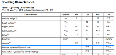

On revision 5 of the MPXM2051G specification, 22 April 2021, on page 5 the Linearity in Table 4 shows a min of -0.3 and a max of +3.0 %Vfss. The maximum of +3.0 % seems high. Is this spec correct?

the application engineer confirmed, that the max. linearity value is a typo and it should be 0.3%VFSS, not the not 3%VFSS.

Thanks for the reply. Sorry to be a bother, but on Rev 4 of the MPXM2051G specification the Linearity is listed as -0.3% to +0.3%, page 4, table 3. This is also the case for revision 1, 2, and 3 of the MPXM2051G spec. Revision 4 of the spec is attached.
The revision history on the rev 5 specification also does not mention a change to the Linearity spec.

thank you for the research you have conducted. Due to the new information you shared I think yes, the max. linearity value is most probably 0.3%VFSS, not 3%VFSS. I have contacted an application engineer for confirming the correct value and asked to fix the mistake in the datasheet rev. 5 if the 0.3% is correct. I will let you know the answer from the application engineer.
