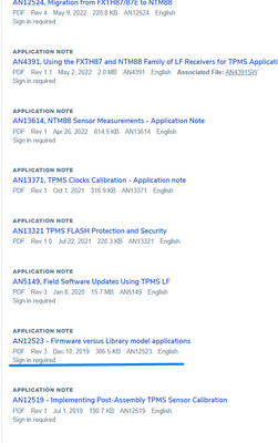

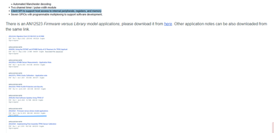

JozefKozon
Hi Markel,
according to UM11227, the NTM88 supports client SPI for host access to internal peripherals, registers, and memory.
There is an AN12523 Firmware versus Library model applications, please download it from here. Other application notes can be also downloaded from the same link.
