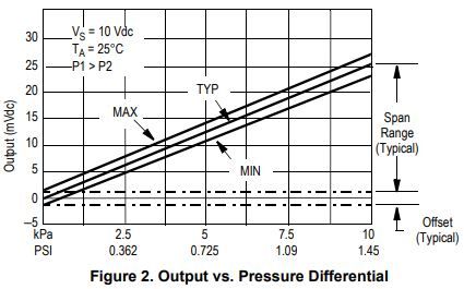

I have not heard about a similar problem before. Each MPX2010GP pressure sensor is laser trimmed for full scale output, offset and temperature compensation.
Figure 2 shows the differential output voltage of the MPX2010GP at +25°C and 10V supply voltage.
Are you using op amps on the outputs to amplify the differential output voltage? You can find some information about that e.g. in the old AN1318, but my recommendation would be using a single chip solution such as the INA122 instrumentation amplifier.
