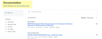

I do recommend reviewing the documents from the pressure sensor series requested (MPX5700 for example) for further information.

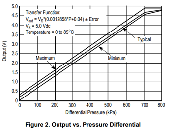

diazmarin09
Bonjour,
I hope all is great with you. Thank you for using the NXP communities.
Below, you may find the relation between the applied pressure and the output voltage:
Could you please share more details about the information that you need about the MPX5700 device?
