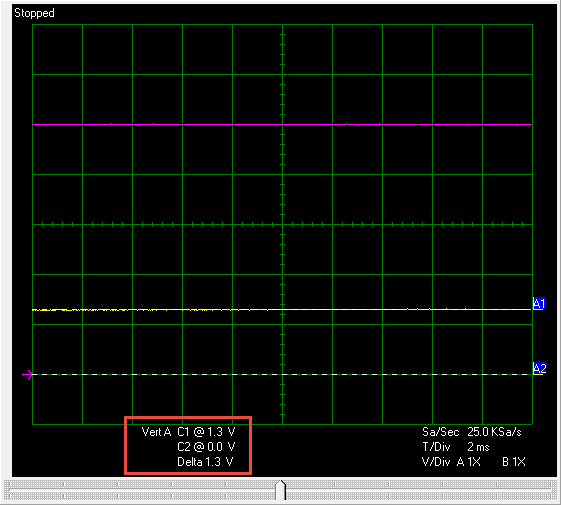

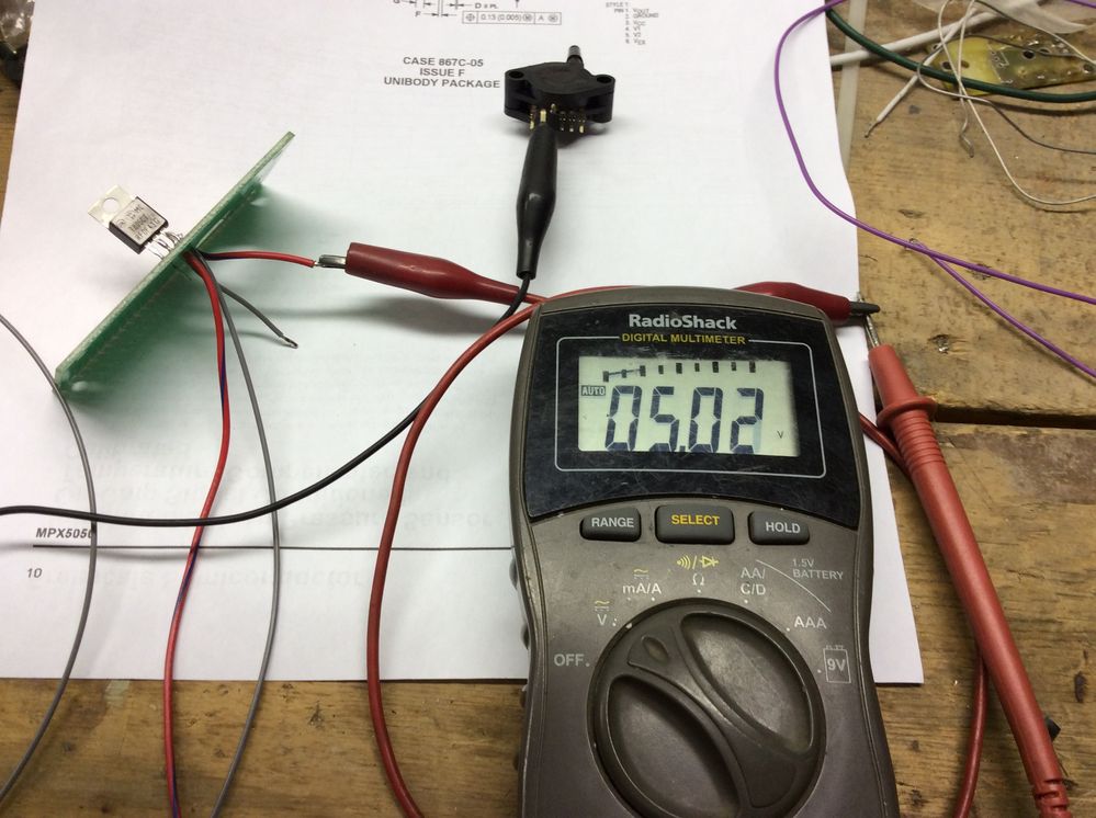

I am trying to use a MPX5050DP sensor.  I am using a MC7805 three terminal regulator to convert 12VDC to 5VDC.  I have connected 5VDC to pin 3 (Vcc) and ground to pin 2.  When I measure the voltage at pin 1 (Vout) with no differential pressure, I observe about 2VDC.  From the datasheet, I expect nearly 0 VDC.  When I blow into the sensor, the voltage changes only .1 or .2 VDC.  I have experienced this with two different MPX5050 and with a MPXV5050DP.  Why isn't the output 0 (or actually .2) with no differential pressure?

When I measure my power supply without the sensor connected, I have 5 volts.  When I connect the sensor pin 3, the voltage drops to about 1.2 volts and the output voltage is about the same, 1.2 volts.  I see this with both MPX5050DP unitbody sensors and with MPXV5050DP small outline sensor.
My power supply is a 12 volt 10 amp supply with a two resistor voltage divider giving me 5 volts.  It certainly has plenty of amps to operate the sensor (its not a voltage drop due to load).

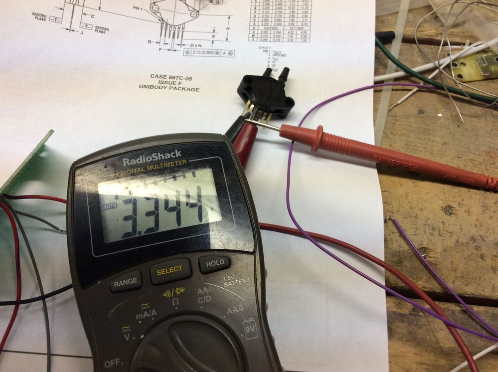

I apply 5 vdc to pin 3 and ground to pin 2. I measure the output on pin 1.  I measure the 5 vdc before connecting to pin 3 and it is 5 vdc.  When I connect it, the voltage drops to about 3 vdc and pin 1 reads the same voltage. All three MPX5050DP I have do the same thing.

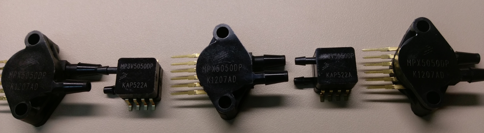

This is a very strange behavior, I'm requesting some samples of the MPX5050DP to test them in our lab, meanwhile, can you please send me some pictures of your "failing" devices to check the complete part marking and confirm with the fabric if there is a known issue, please?
Also, if you can send me a picture of the HW setup of your test to replicate it on my tests would be useful.

jimbutcher
Jose

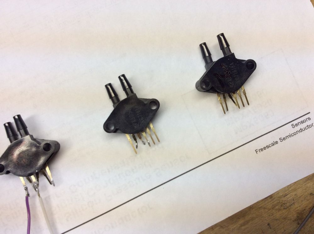

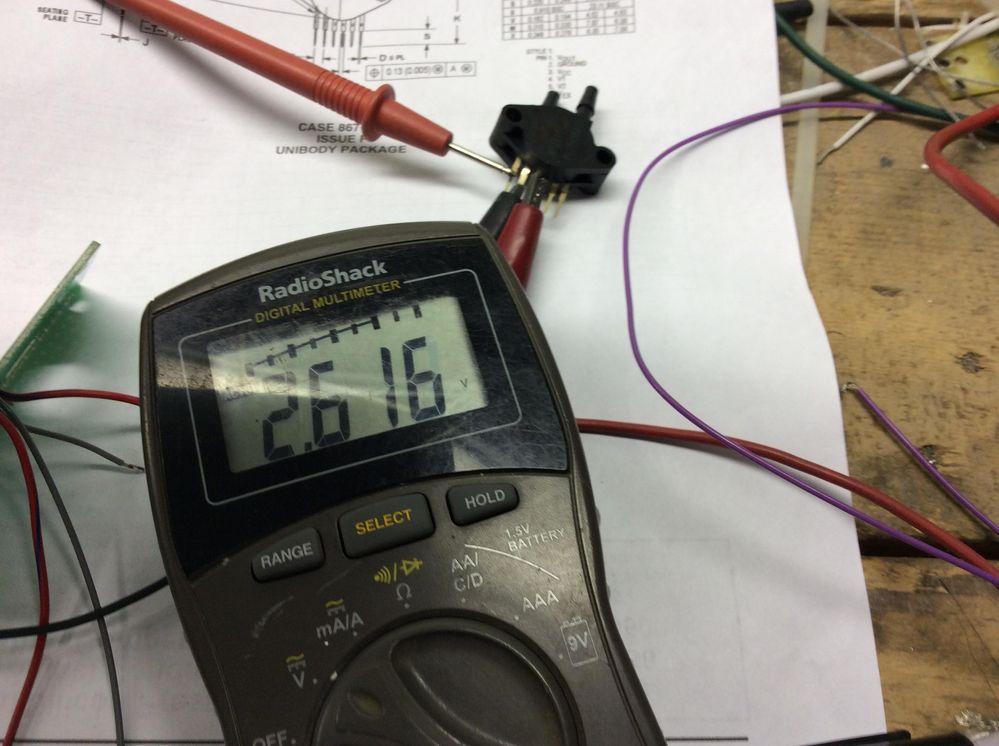

Here are some photos.
I now have three sensors.  Two were purchased from Digikey and the  case says MPX5050DP KGJ1618A.  The other was purchased from Newark Electronics and the case says MPS5050DP KGK1622A.
Below are photos of 1, all three sensors, voltmeter showing 5 vdc from 3 terminal regulator, volts on pin 3 when 5 vdc connected to pin 3, and volts on pin 1 with 5vdc on pin 3.  Note that volts on pin 1 varies up and down at least .1 volt
Photos:

reyes
Hello Jim,
Thank you for share the details with me, I'm doing a little more research with the product engineers meanwhile the samples arrive.
One other request, Can you test your pressure sensors using a different power supply?
Jose

jimbutcher
Jose.
I have tried this using a 12 volt power supply and a three terminal regulator to convert to 5 vdc.  I also tried using the same power supply and two resistors in a voltage divider.  I also tried the three terminal regulator and a 12 volt battery.  Same result.

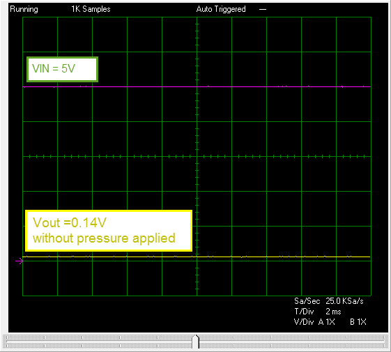

I received my samples of the MPX5050DP and the MP3V5050DP and I have just tested them and they work as expected:
MPX5050DP:
Vin = 5V on pin 3
GND on pin 2
Vout closed to 0V without any pressure applied.
And the output properly change when pressure is applied to port 1:
And with the MP3V5050DP I get very similar results but using VIN at 3.0V.
I have strong reasons to believe that the devices that you are receiving have a quality issue, I recommend you to contact your distributor directly and ask them to create a CQI Quality ticket with NXP.

Thank you for the update.  What is the number on the one's you tested?  Mine are KGJ1618A and KGK1622A.
Jim Butcher
9,187件の閲覧回数
reyes
Hi Jim,
Sure, numbers on the pressure sensors that I tested are:
MPX5050DP: K1207AD
MP3V5050DP: KAP522A
Jose

I just checked both sensors and each draws 1.36 ma.

Hi Jim,
Just adding something:
When I say that without any pressure applied the resultant voltage should be “close to 0V”, I mean that it can be around the zero pressure offset value, for the MPX5050DP, this means that it could be between 0.088V and 0.313V without any pressure applied.
This offset can be eliminated applying a pressure calibration with your mcu, this is explained in the application note AN1636.
