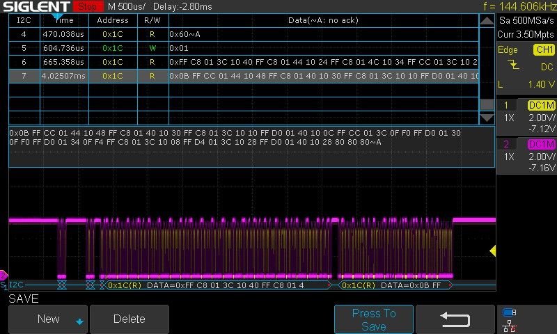

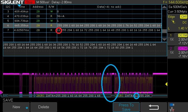

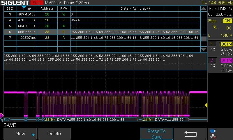

I am only left to believe that the problem is in the I2C burst read on my ESP32-S3
So out comes the o-scope with I2C protocol decoding...
1- The 192 byte read is interrupted right before the "11" (decimal) value which we saw in line 21 of the raw data mentioned earlier.
2- Switching the output to hexidecimal, we can see line 5 of the decoding writes the register address 0x01 which is the lead byte of the FIFO buffer. The 192 byte read then begins. (Incidentally, lines 3 and 4 are the resetting of the interrupt flag of the MMA8451Q and the results do not change if I move this reset to after the FIFO read).
This image shows the line 6 full decoding of the FIFO data up to the point of the break in the clock signal.
3- This next screen capture shows the line 7 decoding of the FIFO data after the break in the clock signal:
4- In the final screen capture, below, I am zooming in on the clock (SCL) (yellow) and data (SDA) (purple) signals around the "glitch". The top pair of traces indicates the zoom window and the bottom pair of traces is the zoomed in data. What we see here is:
- a 8u-sec low clock (green oval) followed by 0x10 then
- a 91u-sec high clock and then
- the 0x0B (11 decimal) (blue oval) followed by
- a skipped click cycle and then
- two bytes of data that make no sense where they are (there appears to be four bytes from the the FIFO missing here or an offset in the pattern of that many bytes) and then
- a resumption of the data pattern which appears to be correct data
Does all this give us an indication of why we are seeing this break in the 192 byte data stream?
(and again, for the record, this is using the set-up suggested by your colleague.  )
