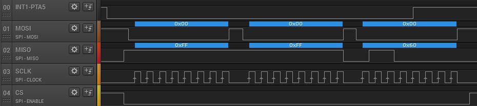

In the ISR, only the interrupt flag is cleared and the FIFO_DataReady variable is set to indicate that the FIFO is full.
void PORTA_IRQHandler()
PORTA_PCR5 |= PORT_PCR_ISF_MASK; // Clear the interrupt flag
FIFO_DataReady = 1;
Once the FIFO_DataReady variable is set, the STATUS register (0x00) is read to clear the FIFO interrupt status bit and deassert the INT1 pin. Afterwars the FIFO is read using a 192-byte (3 x 2 x 32 bytes) burst read starting from the OUT_X_MSB register (0x01). Then the raw acceleration data are converted to signed 14-bit values and real values in g’s.

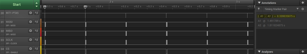

Deassertion of the INT1 pin after reading the STATUS register (0x00).
ODR is set to 100Hz, so the FIFO is read every 320 ms (10 ms x 32 samples).

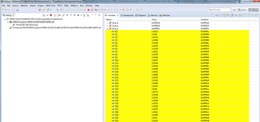

The calculated values can be watched in the "Variables" window on the top right of the Debug perspective.
