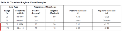

I would like to ask how the sensitivity of the MMA6827 is calculated, and why the sensitivity of the 120g 10bit data bit is 0.24414  Thank you very much

The sensitivity of the device is mentioned on the chapter 3.4 from the datasheet:
No additional calculation is needed, just the signed decimal value from the 10-bit digital output multiplied by the sensitivity (g/LSB) and you get the acceleration in Gs. Note that the acceleration is given in LSB/g so you need to calculate the reciprocal.
Example: reciprocal(4.096 LSB/g) x 480 LSB  =  117.19 g   (trimmed for maximum range)
I hope this information helps.

I would like to know how the sensitivity of 0.24414 is calculated based on the range in the table above, thank you very much!

In that case, those values are related to the thresholds to be used by the arming function. Refer to Section 4.8.9 at datasheet for more details regarding the arming function.

Thank you very much for your previous answer. I wonder if the MM6827 can set the range and sensitivity? I didn't see the specific register, thank you very much!

I am afraid that both the range and sensitivity are fixed.
