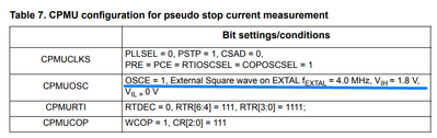

Hi Mike,
please check the OSCE bit in the CPMUOSC register. It should be set to 1 to see an external wave on the EXTAL pin.
With Best Regards,
Jozef
