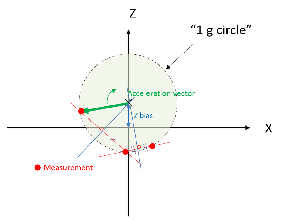

Dear All,
I am using FXTH8719xxxx Family XZ axis Accelerometer Sensor. I need to find the direction as well how much angle turned by using X-axis ans Z Axis data. If any one can help me the possibility?
Each sensor Z-Axis have the different offset values, help me how to calibrate the Z-axis with the new sensor.

what is the values for Z0 - Z base values, How to find the Z base values?

anthonyduhamel
Hi Hulandaivel,
There are several methods to calibrate sensor offsets. The big limitation with an accelerometer is you need to do the calibration phase with quasi-static data. I mean: if you move the FXTH8719xxxx , you will add an acceleration vector on both axis (Z & X) and this will degrade/pervert the calibration... So you have to take care of the sensor rotation by doing very smooth motion (external acceleration should be very small compared to the 1g-force).
About calibration algorithms:
1. You can collect data/measurements around the circle in a buffer. When the full revolution is done, you compute the Z offset with an optimization method to minimize the standard deviation of the 1g vector on all measurements.
2. You can calculate the circle center with 3 points only. (Basic equations & resolution)

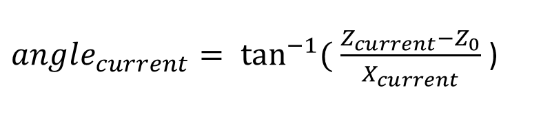

The final angle can be calulated with the following equation:
-Z0 the Z bias
- Z current / X current  are the actual measurements.
Note that these equations are only valid in a static model and are using the 1g gravitational force as reference.
I hope it helps.
Anthony
