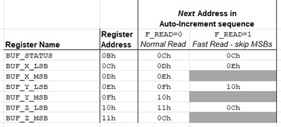

I don't find the datasheet at all clear on how to read out the values from the FIFO.
Is it necessary to repeatedly read the individual triplets
for each triplet
   sensor_comm_read( handle, FXLS896xAF_BUF_X_LSB, 6, data );
Or will a single burst read get all the triplets
sensor_comm_read( handle, FXLS896xAF_BUF_X_LSB, number_of_triplets*6, data );
ie, does the auto-increment loop-back from BUF_Z_MSB to BUF_X_LSB so long as there is more data in the FIFO?

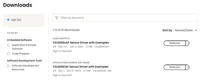

I do recommend downloading the driver example from the link below and using it as a reference for your design.
Sensor Drivers for NXP Sensors

I'm sorry, that doesn't answer the question at all.
The question is, to read the entire FIFO:
  1. can I read the entire FIFO with a single burst read, or
  2. must I do multiple burst reads - one for each (X,Y,Z) triplet ?
In other words, what happens in a burst read after reading BUF_Z_MSB (0x11):
  • does it "loop-back" to BUF_X_LSB (0x0C), or
  • does it carry on to PROD_REV (0x12) ?

As already noted, that Table 20 in the datasheet is very confusing:
https://community.nxp.com/t5/Sensors/FXLS8967AF-Confused-by-quot-Auto-increment-Address-quot/m-p/178...
But I think I've now managed to figure it out:
So a Normal (F_READ=0) burst read of 13 bytes starting at 0x0B should get:
  1. BUF_STATUS (0Bh)
  2. BUF_X_LSB  (0Ch)
  3. BUF_X_MSB  (0Dh)
  4. BUF_Y_LSB  (0Eh)
  5. BUF_Y_MSB  (0Fh)
  6. BUF_Z_LSB  (10h)
  7. BUF_Z_MSB  (11h)
  8. BUF_X_LSB  (0Ch)
  9. BUF_X_MSB  (0Dh)
  10. BUF_Y_LSB  (0Eh)
  11. BUF_Y_MSB  (0Fh)
  12. BUF_Z_LSB  (10h)
  13. BUF_Z_MSB  (11h)
Yes ?
Or have I still not understood Table 20 ?
4,366 次查看
diazmarin09
Hello andrewneil,
I know that Table 20 is indeed confusing, but your understanding is correct. I mean, that is the expected registers sequence with the auto-increment feature and F_READ=0.
David
4,362 次查看
andrewneil
Good.
So it should require just one burst to read the entire FIFO?
BUF_STATUS[BUF_CNT]  indicates the number of triplets required, so the total burst length required would be six times the BUF_STATUS[BUF_CNT] value ?
It certainly is!
I will update the other thread on that topic:
4,351 次查看
diazmarin09
Hello andrewneil,
BUF_STATUS[BUF_CNT]  indicates the number of triplets required, so the total burst length required would be six times the BUF_STATUS[BUF_CNT] value?
You are correct, my apologies for the confusion. I do appreciate your efforts.
