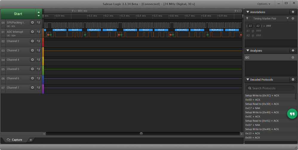

I am using the FSAX21002 on the FRDM-STBC-AGM01 board along with the FRDM-KL25Z and writing all the code using mbed. The issue that I am having is that the sensor does generate any interrupts no matter how I setup the sensor. I have tried using both with interrupts for the FIFO and for Data Ready in all cases no interrupt is generated. My setting tried for the interrupts are for the data ready interrupt (CRTL_REG2 - 0x0F or 0x0E) and for the FIFO interrupt (CRTL_REG2 - 0xC3 or 0xC2) all these setting produced no results. When using the FIFO F_SETUP was set to 0x54. My setup code is below.

Here is a logic capture of some of the setup and some data capture
Setup and data capture (First two blips verify the devices, FXAS and FXOS using the ID registers, next blip is FXAS setup and then finally data capture)

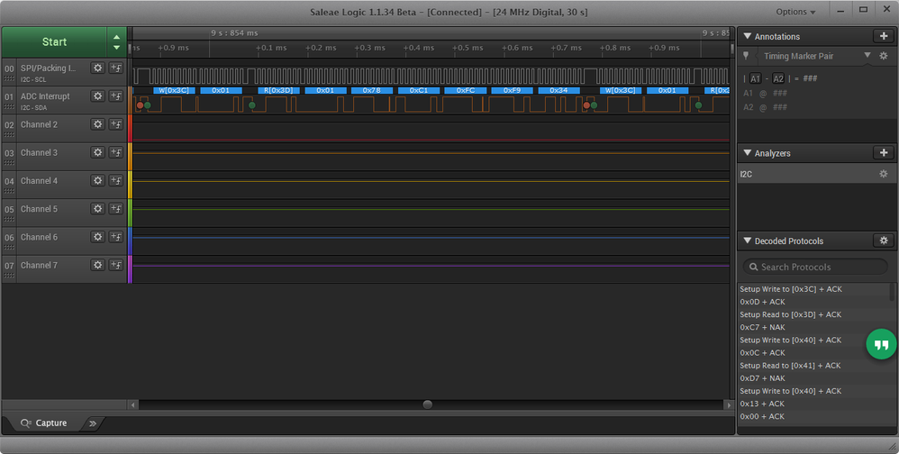

FXOS setup

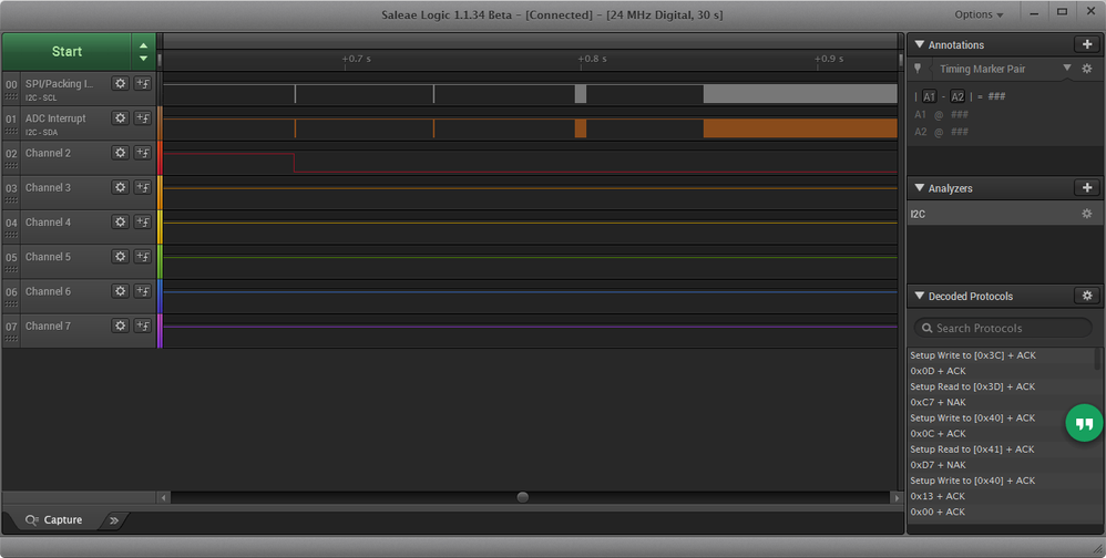

Data Capture
