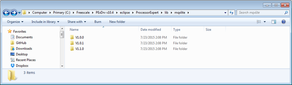

I am trying to develop a project with the sensor fusion library on a Freedom KL26Z
I went to this page Sensor Fusion|Freescale
Downloaded and installed the sensor fusion library
Then imported into CodeWarrior the project correctly. So far I think it's good
I then tried a first compilation but I get immediatly an error :
DescriptionResourcePathLocationType
mqxlite.h: No such file or directory mqxlite.h: No such file or directoryMQX1.h/FSFK_KL26Z/Generated_Codeline 69C/C++ Problem
Hum ok. Is there some code generation to run before being able to compile successfully ?
I hope someone can help me out a little to start.

remibeges
I have found the solution. First, in the Components tab, I changed manually the MQXlite version from 1.1.1 to 1.1.0. This removed the warning ("MQXlite version not found, ...") Then right click on ProcessorExpert in the treeview, and click on generate processor expert code. Compiling the code now works after that.
So indeed there was some code generation to perform, which was not specified on the documentation. Now, my main problem is solved, but I would like to understand why the specified path in MQX1.h was wrong, preventing I suppose processor expert to generate code appropriately. If you have any information about that, I would appreciate it a lot. Regards

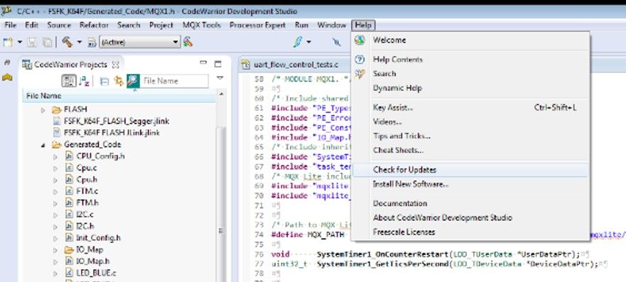

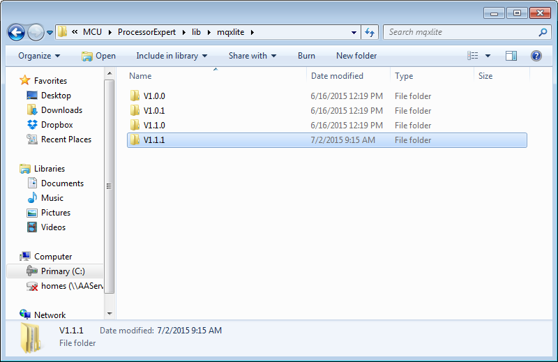

isaacavila
Hi Remy,
Actually there is a V1.1.1 version for processor expert libraries (as shown below) but you need to update some packages (I dont remeber which one exactly) in CodeWarrior.
I think Sensor fusion library was made supposing last update for processor expert was already installed.
Could you try installing all packages for CodeWarrior?
You can make this on CodeWarrio's Help Tab and select Check for Updates.
Check for Updates.jpgI hope this can help you.
Isaac

And there is still no 1.1.1 folder for mqxlite
Any idea what is causing that ?
EDIT : I also tried to manually update MQX lite. I downloaded the drivers from here (Freescale MQX™ Lite Real-Time Operating|Freescale ) but once installed, I still do not have the 1.1.1 folder
EDIT 2 : I tried again to do the update, this time it worked (although I still had the "no repository found" error). Maybe it was just bad luck and the server was down when I tried the first time, but anyway now I have the 1.1.1 version

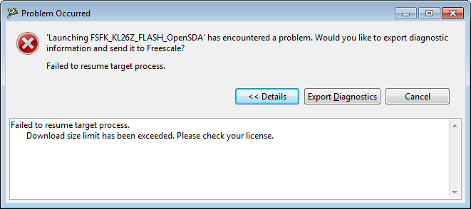

So now I am able to launch the debug. but new issue :
I have the special edition of CodeWarrior, but limits are at least 64kB. Does the sensor fusion lib takes more space than that ?

michaelestanley
Some of the algorithms in the fusion library do take more then 64KB flash.  And the default build definately exceeds those limits.  Open up docs/XSFLK_DS.pdf (the datasheet) and check out tables 15 through 17.
Altough I personally prefer CodeWarrior, it has been deprecated in favor of KDS, which is 100% free with no code size limitations.
Mike

remibeges
Thank you for the answer, Allright I'll switch to KDS then. Thank you for the help everyone, I really appreciate it Regards, Remi
