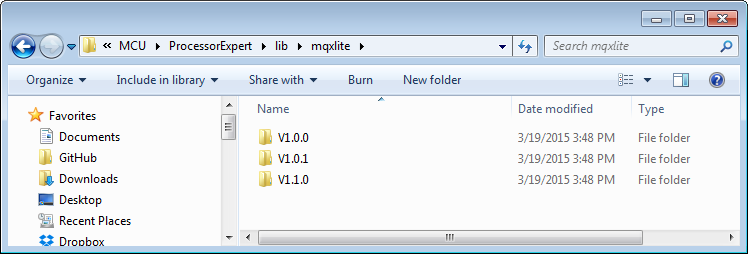

I then tried a first compilation but I get immediatly an error :
DescriptionResourcePathLocationType
mqxlite.h: No such file or directory mqxlite.h: No such file or directoryMQX1.h/FSFK_KL26Z/Generated_Codeline 69C/C++ Problem
Hum ok. Is there some code generation to run before being able to compile successfully ?

Why is there an absolute path in there ? Which, furthermore, points to nowhere on my computer :
If I understand correctly, this file is generated automatically when I downloaded and installed the sensor fusion library. Which means, and correct me if I'm wrong, if I want to open source this project, using versionning tools such as github.com, this absolute path will be the same for everyone. But, if other contributors install the library on a different path on their computers than mine, the code will not compile. This is very not portable, so if someone can explain the reason for this, I'd really appreciate it

isaacavila
Hi Remy,
Actually there is a V1.1.1 version for processor expert libraries (as shown below) but you need to update some packages (I dont remeber which one exactly) in CodeWarrior.
I think Sensor fusion library was made supposing last update for processor expert was already installed.
Could you try installing all packages for CodeWarrior?
You can make this on CodeWarrio's Help Tab and select Check for Updates.
Check for Updates.jpgI hope this can help you.

remibeges
Hello Isaac I tried updating all packages, but I get several errors
Some sites could not be found.  See the error log for more detail.
No repository found at jar:file:C:%5CUsers%5CB48923%5CDownloads%5CCW%20for%20MCU%2010.6%5Ccom.freescale.mcu10_6.kinetis.updatesite.zip!/.
No repository found at jar:file:C:%5CUsers%5CB48923%5CDownloads%5CCW%20for%20MCU%2010.6%5Ccom.freescale.mcu10_6.e200.updatesite.zip!/.
No repository found at jar:file:C:%5CUsers%5CB48923%5CDownloads%5CCW%20for%20MCU%2010.6%5Ccom.freescale.mcu10_6.coldfire.updatesite.zip!/.
An error occurred while collecting items to be installed
session context was:(profile=PlatformProfile, phase=org.eclipse.equinox.internal.p2.engine.phases.Collect, operand=, action=).
Unable to read repository at http://freescale.com/lgfiles/updates/Eclipse/MCU10_6/com.freescale.mcu.updatesite/plugins/com.freesc....
chunked stream ended unexpectedly
Unable to read repository at http://freescale.com/lgfiles/updates/Eclipse/MCU10_6/com.freescale.mcu.updatesite/binary/com.freesca....
Most packages have not updated, because when I re-run the update tool I still have the same packages proposed.
And there is still no 1.1.1 folder for mqxlite
Any idea what is causing that ?
EDIT : I also tried to manually update MQX lite. I downloaded the drivers from here (Freescale MQX™ Lite Real-Time Operating|Freescale ) but once installed, I still do not have the 1.1.1 folder
EDIT 2 : I tried again to do the update, this time it worked (although I still had the "no repository found" error). Maybe it was just bad luck and the server was down when I tried the first time, but anyway now I have the 1.1.1 version
