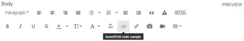

How to put the code in the frame? Like <code> in standard forums?

The code can be inserted/edited using the Insert/Edit code sample button:
