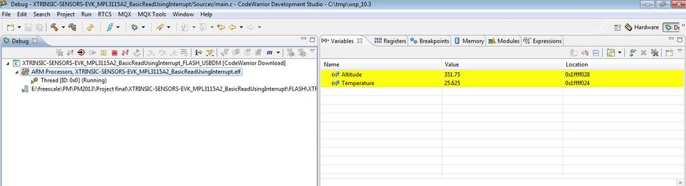

Hi Everyone,
I would like to share a simple example code/demo that reads both the altitude and temperature data from the Xtrinsic MPL3115A2 pressure sensor and visualizes them using the FreeMASTER tool via USBDM interface. I have used recently released Xtrinsic MEMS sensors board that features three types of Xtrinsic sensors including the MPL3115A2 and is fully compatible with the Freescale FRDM-KL25Z platform.
According to the User Manual, both interrupt pins of the MPL3115A2 are connected to the PTD3 pin of KL25Z MCU through a 4.7K pull-up resistor as well as both SCL and SDA lines that are connected to the I2C1 module (PTE1 and PTE0 pins) on the KL25Z. The MCU is, therefore, configured as follows:

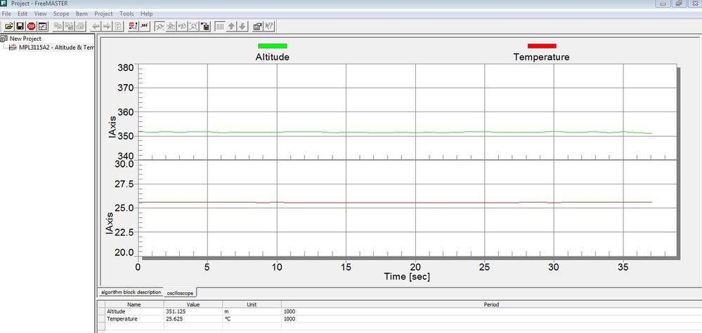

The calculated values can be watched in the "Variables" window on the top right of the Debug perspective or in the FreeMASTER application.
Attached you can find the complete source code written in the CW 10.3 as well as the FreeMASTER project.
If there are any questions regarding this simple application, please feel free to ask below. Your feedback or suggestions are also welcome.
