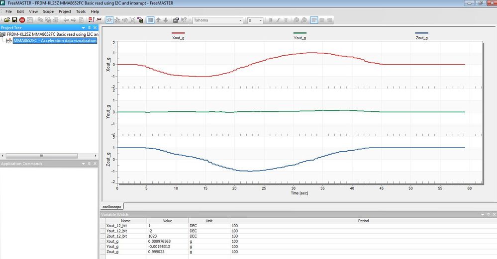

7. Visualization of the output values in the FreeMASTER tool.

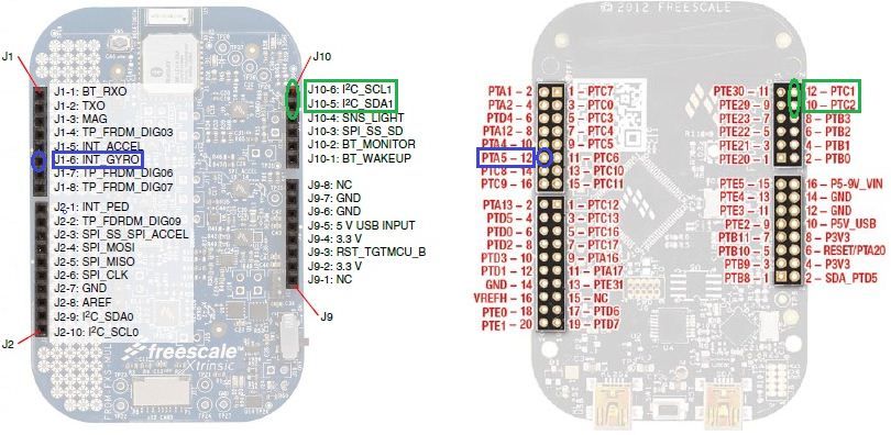

1. As you can see in the FRDM-FXS-MULTI(-B)/FRDM-KL25Z schematics and the image below, I2C signals are routed to the I2C1 module (PTC1 and PTC2 pins) of the KL25Z MCU and the INT1 output is connected to the PTA5 pin (make sure that pin #3 of J4 and pin #2 of J6 connector on the sensor expansion board are connected together). The INT1 output of the MMA8652FC is configured as a push-pull active-low output, so the corresponding PTA5 pin configuration is GPIO with an interrupt on falling edge.
The MCU is, therefore, configured as follows.

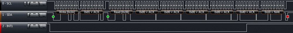

2. The 7-bit I2C address of the MMA8652FC is fixed value 0x1D. As shown above, the SCL line is connected to the PTC1 pin and SDA line to the PTC2 pin. The I2C clock frequency is 125 kHz.
The screenshot below shows the write operation which writes the value 0x39 to the CTRL_REG1 (0x2A).
And here is the single byte read from the WHO_AM_I register 0x0D. As you can see, it returns the correct value 0x4A.
Multiple bytes of data can be read from sequential registers after each MMA8652FC acknowledgment (AK) is received until a no acknowledge (NAK) occurs from the KL25Z followed by a stop condition (SP) signaling an end of transmission. A burst read of 6 bytes from registers 0x01 to 0x06 is shown below. It also shows how the INT1 pin is automatically deasserted by reading the acceleration output data.

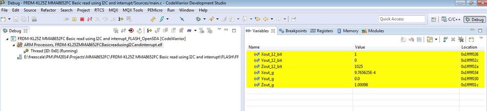

7. The calculated values can be watched in the "Variables" window on the top right of the Debug perspective or in the FreeMASTER application. To open and run the FreeMASTER project, install the FreeMASTER application and FreeMASTER Communication Driver.
Attached you can find the complete source code written in the CW for MCU's (Eclipse IDE) including the FreeMASTER project.
