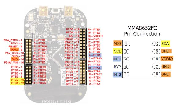

1. As you can see in the FRDM-KL25Z schematic and the image below, the I2C signals are routed to the I2C1 module (PTC1 and PTC2 pins) of the KL25Z MCU and the INT1 and INT2 outputs are connected to the PTD5 and PTA5 pins. The INT1 and INT2 outputs of the MMA8652FC are configured as a push-pull active-low outputs, so the corresponding PTD5 and PTA5 pins configuration are GPIOs with an interrupt on falling edge.
The MCU is, therefore, configured as follows:

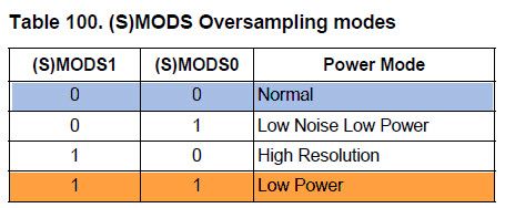

2. The MMA8652FC is an intelligent, low-power, three-axis, capacitive micromachined accelerometer with 12 bits of resolution.
At the beginning of the initialization, all registers are reset to their default values by setting the RST bit of the CTRL_REG2 register. The Normal and Low Power modes are set in the same register. The MODS[1:0] bits select which Oversampling mode is to be used. The Oversampling modes are available in both WAKE Mode MOD[1:0] and also in the SLEEP Mode SMOD[1:0].
Then the MMA8652FC is initialized as shown below:
     I2C_WriteRegister(MMA8652FC_I2C_ADDRESS, CTRL_REG2, 0x40);        // Reset all registers to POR values
     Pause(0x631);        // ~1ms delay
     I2C_WriteRegister(MMA8652FC_I2C_ADDRESS, XYZ_DATA_CFG_REG, 0x00); // +/-2g range with ~0.977mg/LSB
     /* Power Mode Configuration */
     If LOW power mode is selected:
     I2C_WriteRegister(MMA8652FC_I2C_ADDRESS, CTRL_REG2, 0x1B);        // Low Power mode
     If NORMAL power mode is selected:
     I2C_WriteRegister(MMA8652FC_I2C_ADDRESS, CTRL_REG2, 0x00);        // Normal mode

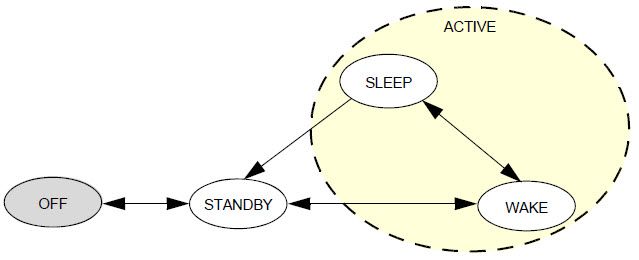

3. As I mentioned, one of the main features of the MMA8652FC is the Auto-WAKE/SLEEP mode.
The advantage of using the Auto-WAKE/SLEEP is that the system can automatically transition to a higher sample rate (higher current consumption) when needed, but spends the majority of the time in the SLEEP mode (lower current) when the device does not require higher sampling rates.
Auto-WAKE refers to the device being triggered by one of the interrupt functions to transition to a higher sample rate. This may also interrupt the processor to transition from a SLEEP mode to a higher power mode.
SLEEP mode occurs after the accelerometer has not detected an interrupt for longer than the user-definable timeout period.
At the ASLP_COUNT register, you can set the minimum time period of inactivity required to switch the part between Wake and Sleep status, in this case, 5 seconds.
The Auto-WAKE/SLEEP mode, therefore, is configured as follow:

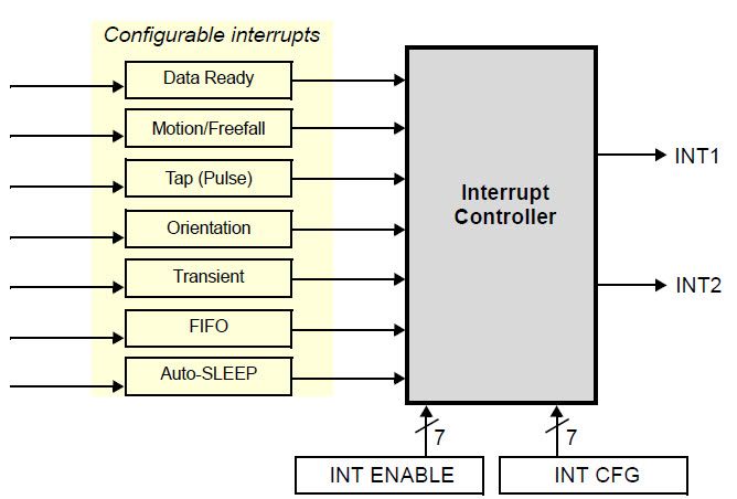

4. The device can be configured to generate inertial wake-up interrupt signals from any combination of the configurable embedded functions, enabling the MMA8652FC to monitor inertial events while remaining in a low-power mode during periods of inactivity.
The Interrupts that can WAKE the device from SLEEP are:
Tap Detection, Orientation Detection, Motion/Freefall, and Transient Detection.
In this project, the TAP (Pulse) or Transient interrupts are used to wake up the device from the SLEEP. In order to get more information about the TAP detection, please click here.

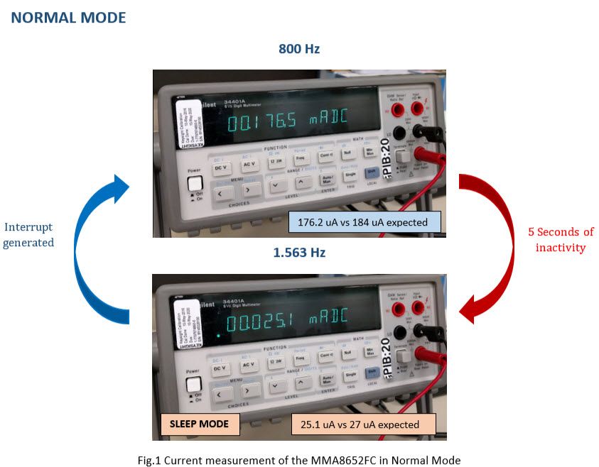

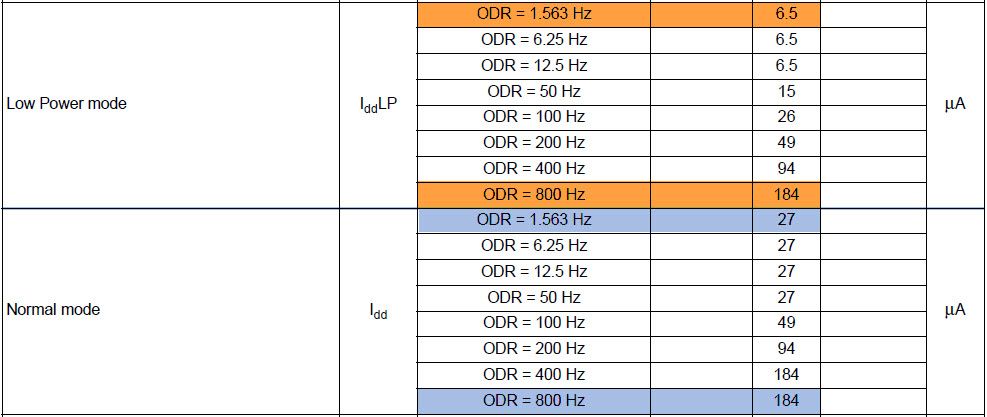

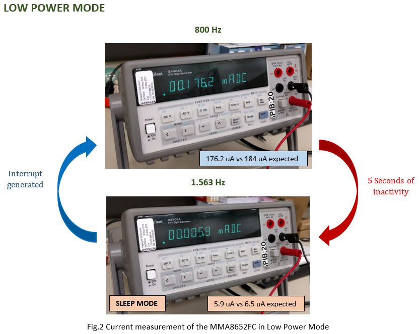

8. The Table 5 from the datasheet shows the expected current consumption in regard with the power mode and ODR selected:
As I mentioned before, the Sleep mode allow us to change between different Output Data Rates (ODR) dynamically so we can reduce the current consumption.
In order to verify if the accelerometer is consuming the current mentioned on the datasheet, I measured the MMA8652FC current consumption using the project mentioned.
Please refer to the results below:
9. The advantage of using the Auto-WAKE/SLEEP mode is that the system can automatically transition to a higher sample rate (higher current consumption) when needed, but spends the majority of the time in the SLEEP mode (lower current) when the device does not require higher sampling rates.
In the manner we have come to expect of the MMA8652FC, the current consumption decreases when the ODR is changed from 800Hz to 1.56Hz, in both normal and low power mode.
The information mentioned on the datasheet is now confirmed.
