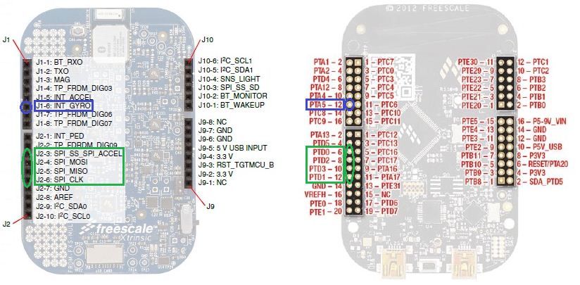

1. As you can see in the FRDM-FXS-MULTI(-B)/FRDM-KL25Z schematics and the image below, SPI signals are routed to the SPI0 module of the KL25Z MCU and the INT1 output is connected to the PTA5 pin (make sure that pins 2-3 of J6 on the sensor board are connected together using a jumper). The PTD0 pin (Chip select) is not controlled automatically by SPI0 module, hence it is configured as a general-purpose output. The INT1 output of the FXLS8471Q is configured as a push-pull active-low output, so the corresponding PTA5 pin configuration is GPIO with an interrupt on falling edge.The core/system clock frequency is 20.97 MHz and SPI clock is 524.25 kHz.
The MCU is, therefore, configured as follows.

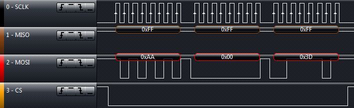

The falling edge on the SA1/CS_B pin starts the SPI communication. A write operation is initiated by transmitting a 1 for the R/W bit. Then the 8-bit register address, ADDR[7:0] is encoded in the first and second serialized bytes. Data to be written starts in the third serialized byte. The order of the bits is as follows:
Byte 0: R/W, ADDR[6], ADDR[5], ADDR[4], ADDR[3], ADDR[2], ADDR[1], ADDR[0]
Byte 1: ADDR[7], X, X, X, X, X, X, X
Byte 2: DATA[7], DATA[6], DATA[5], DATA[4], DATA[3], DATA[2], DATA[1], DATA[0]
The rising edge on the SA1/CS_B pin stops the SPI communication.
Below is the write operation which writes the value 0x3D to the CTRL_REG1 (0x3A).

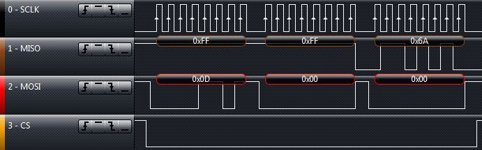

Similarly a read operation is initiated by transmitting a 0 for the R/W bit. Then the 8-bit register address, ADDR[7:0] is encoded in the first and second serialized bytes. The data is read from the MISO pin (MSB first).
The screenshot below shows the read operation which reads the correct value 0x6A from the WHO_AM_I register (0x0D).

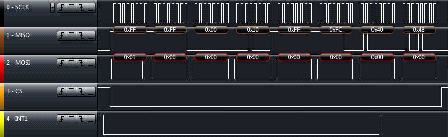

Multiple read operations are performed similar to single read except bytes are read in multiples of eight SCLK cycles. The register address is auto incremented so that every eighth next clock edges will latch the MSB of the next register.
A burst read of 6 bytes from registers 0x01 to 0x06 is shown below. It also shows how the INT1 pin is automatically cleared by reading the acceleration output data.

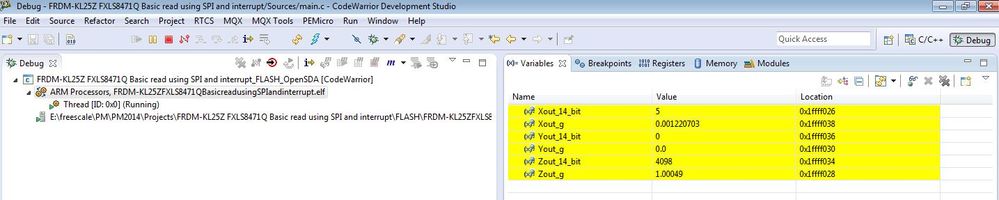

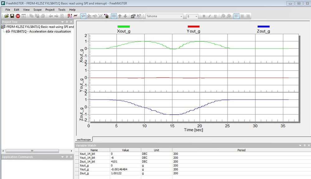

7. The calculated values can be watched in the "Variables" window on the top right of the Debug perspective or in the FreeMASTER application. To open and run the FreeMASTER project, install the FreeMASTER 1.4 application and FreeMASTER Communication Driver.
