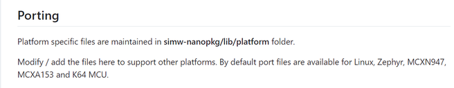

Hi @AnilRathod ,
Actually nordic controller is not supported by the MW, but maybe you can start with the nano package and port it to nordic controller by yourself. Please kindly refer to https://github.com/NXPPlugNTrust/nano-package for details.
Hope that helps,
Kan

Kan_Li
Hi @AnilRathod ,
No, SE05x has no registers inside, you just have to issue APDU commands to the device following the T=1 Over I2C Spec which you need not investigate if you develop your application based on the MW which already includes the implementation.
STM32 is not supported by the MW either, if you want to use STM32 instead, you still have to do the porting.
Kan

Kan_Li
Hi @AnilRathod ,
It is not recommended using raw APDU command in your application, as it can be easily probed via the I2C lines, you have to secure the channel at first, and such kind of functionalities have all been implemented in the MW(https://www.nxp.com/webapp/Download?colCode=SE05x-PLUG-TRUST-MW&appType=license ), you may simply develop your own application code based on the MW which will help you with the command frame construction , no need to take additional time to develop another similar MW.
If you think the full MW is too complicated to port, you may start with the nano version, https://github.com/NXPPlugNTrust/nano-package , as I mentioned before.  Please kindly refer to the following for more details.
Hope that helps,
Kan
