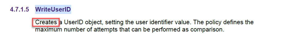

Even if I create a UserID secure object with policy POLICY_OBJ_ALLOW_WRITE, i'm not able to overwrite it using WriteUserID command instead SE050 returns status word 0x6985. Does someone has a working example of such a use case ?

Hi Michael,
I just got the confirmation from the expert, The UserID object cannot be updated, but only be deleted and created new. please kindly refer to the spec for more details.

m_grand
Yes, my application is based on the MW. Hereafter the most simple example that illustrates my problem.
During first call of sss_se05x_write_user_id(), UserID is properly created.
However second call, where i attempt to overwrite UserID value, fails.
Policy is properly applied because EX_SSS_BOOT_DO_ERASE macro actually erases the UserID (which is not the case by default if can_Delete filed is not set to 1).
