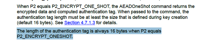

Hi @Zarein94 ,
Thanks for the information!
For AEAD encryption, the length of the authentication tag is always 16 bytes, as mentioned in the APDU spec:
 so please adjust the tag length in your application code accordingly (12 ==> 16).
Please kindly let me know if the problem is still there.

Kan_Li
Hi @Zarein94 ,
Kan
3,681 Views
Zarein94
Thanks @Kan_Li  for your support! That was the problem! It works fine now!
