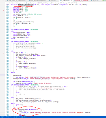

I'm finding a failure in sss/plugin/openssl/engine/src/ax_sssEngine_rsa.c in the function EmbSe_RSA_Priv_Encrypt() where if the RSA padding selected is not set to RSA_NO_PADDING, the call fails. Is this correct or a bug? xml-security-c uses RSA padding RSA_PKCS1_PADDING which complies with the XML security standard.

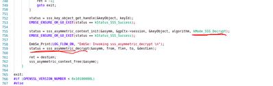

Also, in the same function EmbSe_RSA_Priv_Encrypt(), I notice that sss_asymmetric_context_init() uses the kMode_SSS_Decrypt and makes a call to sss_assymmetric_decrypt(). I intuitively would expect that RSA_Priv_Encrypt() is doing "encrypt" operations, not "decrypt" operations. Is this a bug?

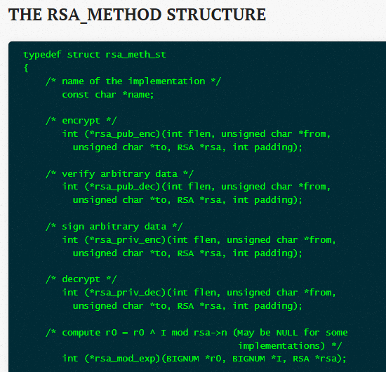

Indeed the function EmbSE_RSA_Priv_Encrypt is actually the method referenced to “sign” data. With RSA the signature is correctly created with the method “decrypt”. From the openSSL documentation:
I agree that the engine’s function name is misleading as it actually should be the signing function.
For the RSA padding methods support, we are checking with the R&D now, will let you know when I have any more info from there.

Thank you Kan. There is no concern with the SE050 not being to support RSA padding. I was able to leverage Openssl's RSA padding commands to achieve what I needed.
