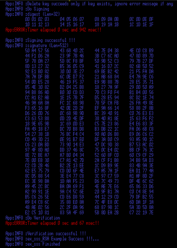

i am working with SE050 Arduino kit connected to Raspberry Pi. In my setup the ECC sign and verify commands are very fast. But if I use RSA 2k keys, I experience in my setup roughly 4 seconds for RSA sign and roughly 4 seconds for RSA verify. Is this an expected performance range or might there be an issue on my side?

one short adder to my previous description. I have realized that RSA verify takes in majority cases roughly 4s, but in few cases (e.g. previous log) much less e.g. 760ms..

BTW, I didn't see and time measurement info from the log, so how did you measure the time? Please kindly clarify.

within above log RSA sign was 4282ms and verify was 761ms. Please look for the line starting with msec time.
RSA sign is very stable in the area of 4282. The RSA verify is either 761ms (in roughly 1/4 cases) or roughly 4000ms (in roughly 3/4 cases).
Please see how I measured:
I have patched the file ex_sss_rsa.c in function ex_sss_entry(…).
On top of the file I have included time.h. I get the time (in ns) before and after the function call
To “sss_asymmetric_sign_digest”. I calculate the time difference and print it.

I think the method you used for measure the timing is correct, but it also take other parts into calculation, for example, since you run the application in the linux, there were multiple tasks run at the same time, so the context switching also consume some time, so I think better measure based on a nonOS situation, you know, we have also released SE050 FRDMK64 version hostlib, based on that you may get the correct RSA performance. Please refer to https://www.nxp.com/webapp/Download?colCode=SDK-FRDM-K64F-SE050 for details.
I use the LPTMR to measure the time and the result is as below:
Please note this result still take the I2C communication into calculation, so the real rsa performance should be shorter.

When measuring the execution time of the call "sss_asymetric_sign_digest" and "sss_asymetric_verify_digest" in ex_sss_ecc.c I can see values around 80ms. Applying the same principle to the calls in file "ex_sss_rsa.c" I end up with values around 4 seconds.
