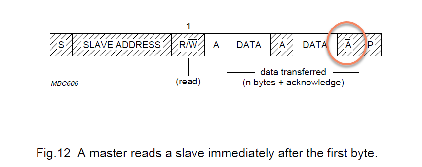

SE050 sometimes don't response READ command, NO ACK when running se05x_Get_Info.
i2c clock 360KHz.
Is that normal situation?

Kan_Li
Hi m.c,
Thanks for the information! Referring to your snapshots of I2C transaction, looks like you write to 0x90 with 0x00 and then read from 0x90, right? Per I2C spec, the master read operation is as below:
Since you just read 1 byte, so there is a not-acknowledge following this byte as it is the last one.
Hope that makes sense,
Kan

m_c
Senior Contributor I
Customer using Linux i2c driver which will check ACK packet after sending request rigorously and print warning message if no ACK. By prevent see this warning, platform provider AMBA suggest add flag in the application when doing i2c read. Is there any cmake option can turn this on (enable I2C_M_IGNORE_NAK flag) or where to add this flag in the source code?
