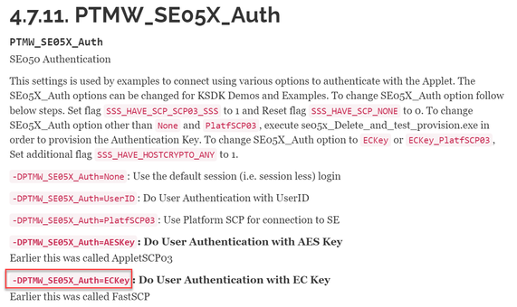

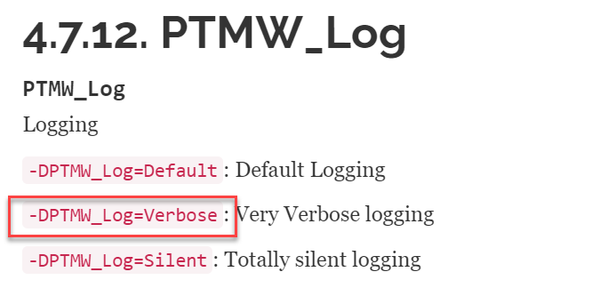

The  authentication object can be trust provisioned out of factory with a secure service, such as edgelock2go secure service , and you may refer to the https://www.nxp.com/products/security-and-authentication/secure-service-2go-platform:SECURE_SERVICE_... for details.
To have an APDU command example regarding how to establish a secure EC key session, you may simply enable ECKey Auth type for the MW and enable the verbose log, so you may have the APDU log when you run any MW example after rebuilding the MW.
Please kindly refer to the following for details.
