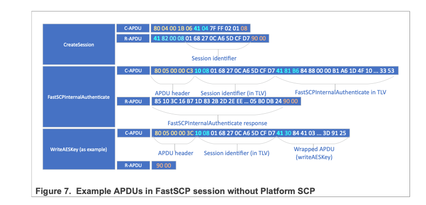

Maybe there is some misunderstanding here. I found you created the ECKey session with ID of 7fff0201, which is provisioned as ECKA pair at SE for EC key Session Authentication, but from my understanding, this session should be created with the ID to store the PK.Host.ECDSA .  so the host side should generate Host.ECDSA at first and write PK.Host.ECDSA as authentication object in SE with a non-reserved ID (e.g. 0x00001000), then create the ECKey session with this ID instead.
Hope that makes sense,
Kan
20,523件の閲覧回数
jychab
Im following the example as shown in the docs.
It uses the Reserved_EC_Key_Sesssion_Id to create the session as well.
20,477件の閲覧回数
Kan_Li
Hi @jychab ,
This figure has been confirmed as a doc issue, the public key from the host and provisioned in SE shall be referenced there.
Kan

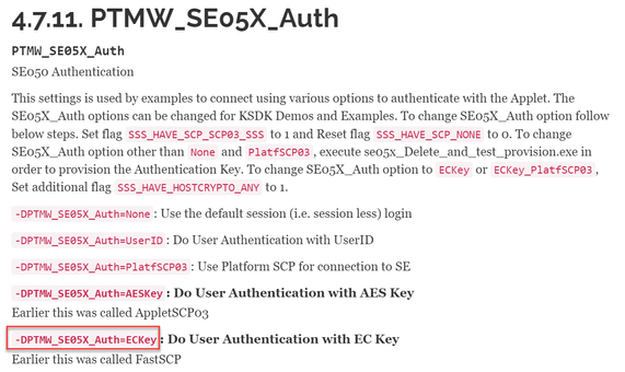

jychab
Are you sure i can create a session using a transient authentication object?
In the documentation for the latest applet, it states that authentication object needs to be a persistent object and it can't be a transient object.
20,365件の閲覧回数
Kan_Li
Hi @jychab ,
Sorry, my bad! The authentication object must be persistent, but as writing ECKey pair always cause NVM writes, so you better let the hosts have the key pair used for authentication after they are registered.
Kan
