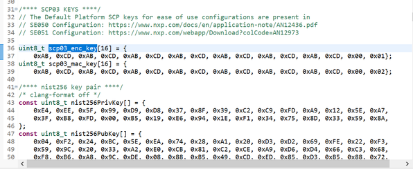

I'm working with the Plug&Trust nano package running on Zephyr.  Unfortunately the SCP keys defined in app note AN12436 for the C2 config (0xA200) do not seem to work.  I'm unable to create a secure channel.  Triple checked everything, nothing obvioius.
Question:  Are there any know issues or compatibility issues w/the Nano package and an SE050C2 config?

Thanks for the info! Actually the key pair you are using is for SE050C2(A201), not C1(A200), Please kindly refer to the following for details.
There is a typo in table 6 of SE050 configurations (nxp.com) and we will update it later.

May I have your SCP03 key definition similar as below?

Keys I'm using.

Thanks Kan, that fixed the problem!
I can now connect using SCP03.
