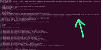

Thank you for your timely support. I am currently also looking to build the SE050 Plug & Trust Middleware on the i.MX8MQ Android OS in order to implement security features on my device. However, it seems there is no official documentation available that explains how to build the SE050 library for Android. If you know of any documents or resources that could guide me, I would greatly appreciate it.

Hi @yang_lee ,
So far we just have guide for Android 9 in simw-top/doc/akm/Readme.html, so you have to adapt it for the version you are using.
Sorry for the inconvenience that might cause,
