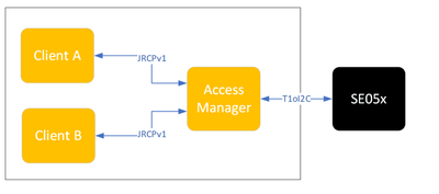

Kan_Li
Hi @ajitsj3 ,
Actually clients work with accessManager as below:
so JRCP_V1_AM is configured for Client applications, when you make install with this configuration, you may find the client application in "/usr/local/bin", but without accessManager, since it is mentioned in cmake menu already.
so you have to configure the MW again with
-DPTMW_SMCOM:STRING=T1oI2C
 and build accessManager like below:
cmake --build . --target accessManager
 then you will find accessManager in bin folder of the building folder, you needn't run "make install" twice, just leave it there, and run it in one console and run the client applications in other consoles.
Please kindly refer to simw-top/doc/hostlib/hostLib/accessManager/doc/accessManager.html for more details.
Hope that makes sense,
Kan
